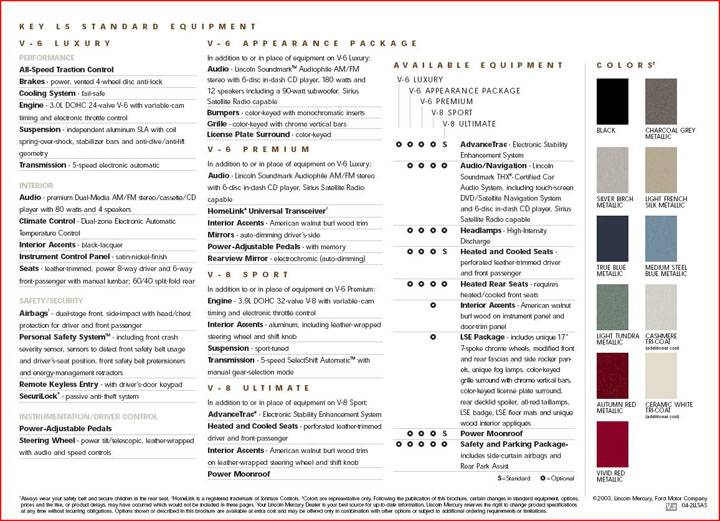

You forgot the LSE package available on the 04 & 05 (became standard on 06 V8's) BTW I do not think the 04 Ultimate had the sport suspension as it was way softer and wallowed compared to the Sport. Also the parts book lists three shocks for the 04, standard, sport and in older books there was also a European shock for the exported cars. The LSE package was only available on the Sport and included the front treatment, side skirts, rear deck spoiler, LSE Walnut burl interior trim and 17" surprisingly light wheels.
Here is an options list for the 04 LS
