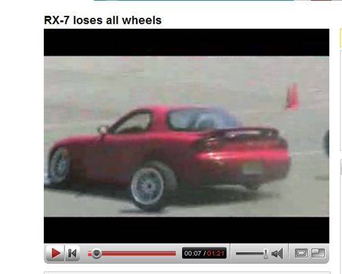

Careful on shaving them wheels...
The wheels look intact, maybe the hub broke off or its photoshoped. If shaving the wheel caused the wheels to break off, then the wheel would be cracked around the center or missing where it bolts to the car. I have read that OEM wheels are normally thicker than aftermarket wheels, so when you shave OEM wheels, the face gets shaved down to about aftermarket thickness. Most shops I have found will do 5mm shave tops to leave enough "meat" on the wheels, buts its easier to do this on OEM according to some shops. When you're borderline rubbing, 5mm extra wiggle room is a lot!
On the pic, I'm going to guess that someone took all the lug nuts off, seeing as someone was onhand with a video camera to catch it in action like that. Still, want to make sure it's not overdone.
