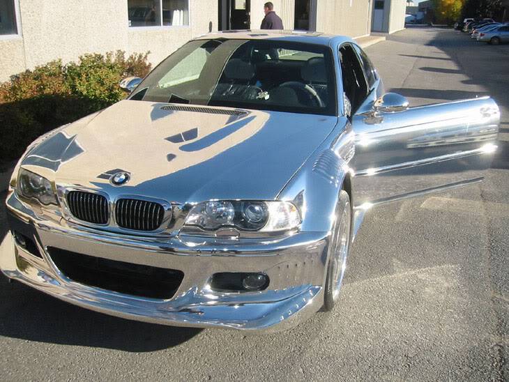

as long as we're opening old threads,i actually like what appears to be a reflection, but the plywood grain looks cool. do the whole car in wood!:eek:
Looks pretty sweet I suppose, but couldn't it blind you if light were to reflect directly to your eyes?
... well I guess that probably wouldn't happen as most cars hoods tend to slope down towards the the front, but for those cars covered in the chrome wrap, they seem the visual hazard only because of glaring. Otherwise, that looks sharp.
Hey, Ray Charles had a chrome car and looks like it blinded him!
j/k Actually Ray did have a chromed car, but wasn't allowed to have it driven on the road because of the "blinding other drivers" issue.
