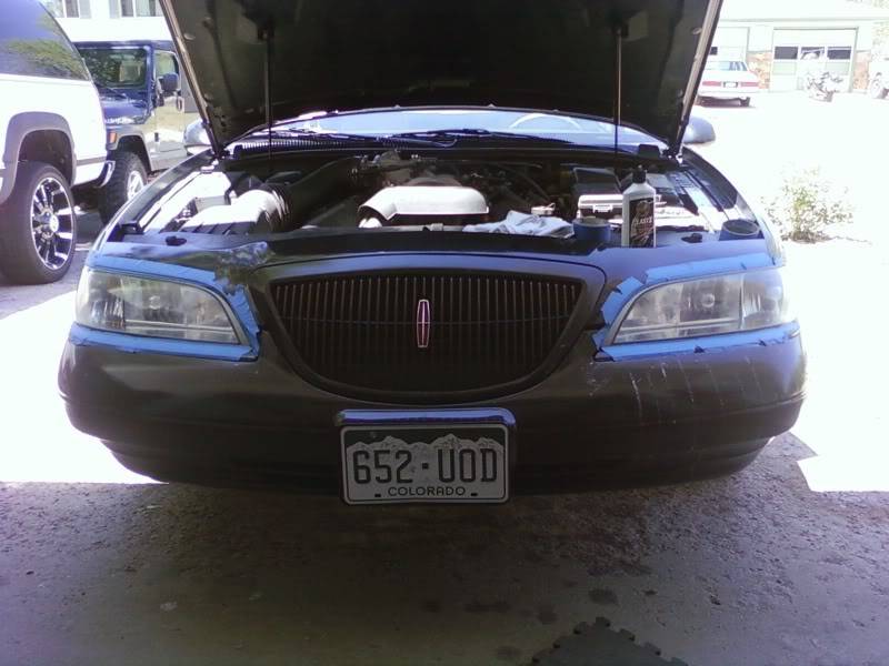

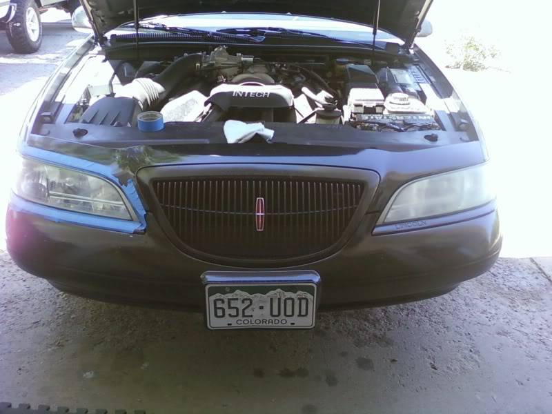

I wet sanded with 1000 grit, and polished with Plastix. Took all of 45 min.
One done:
Finished result
