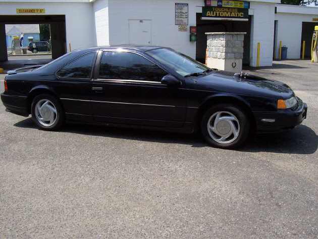

Wanna Laugh. .. I've got a 4000+ T-Bird SC with a puny v6 & a Big Ol'Whipple running 11's. Come March when E-Town opens, I'll hoping to squirt it into the 10's. First gotta get the balls to put the juice in & chance blowing it to kindom come! .... But the joke will be if I can do it with the AC on! :steering

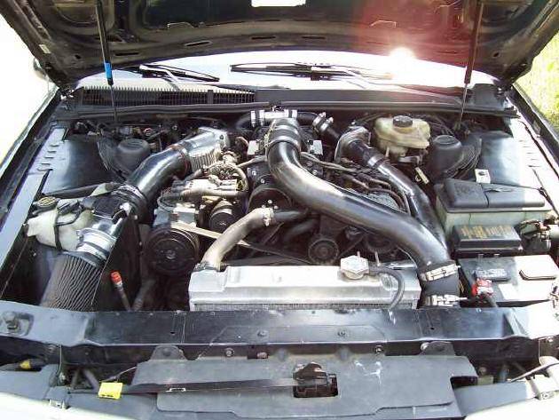

You can adapt the KB kits onto the Marks with ease. Why make a whole new kit for? I have my twin screw supercharged Mark so I am not real game but Im just saying. Plus I could always yank my intake and have it copied.
