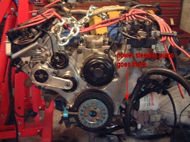

How do I change the power steering pump? Where is it located on the engine? Is there directions somewhere on how to change???
Here is a pic of the engine removed. The power steering pump is removed, but annotated as to where it belongs.
Also....here is the procedures directly from the manual:
