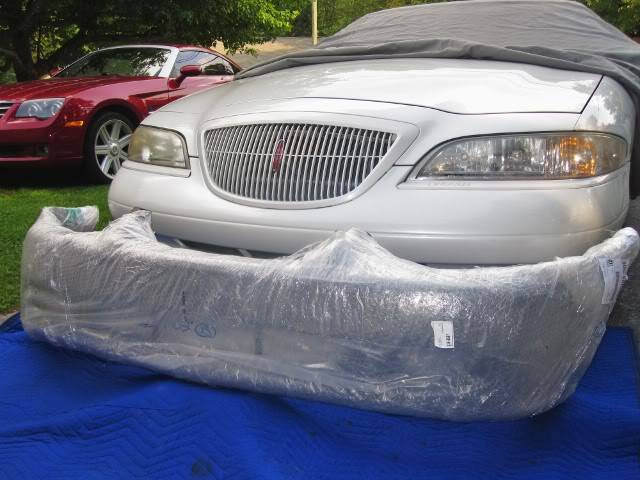

For the rear only, I'm going to line the bumper with foil. Then the inside if the new part as well. I am then going to glue potting foam bricks to the bumper. I will shave them til the part sits close to correct. The ls is wider so I am going to cut it in half down the center. All the bridging will be done with sheets of fiberglass mesh, backed with metal mesh for strength. I am going to have to fab some mounting brackets for the new piece. After the bumper addition is resined and sanded, I will then cut away the lower section of the bumper away, and mount the new section. One thing I will also be doing is making aluminum underbody plates to replace the plastic ones that will no longer fit. Or just aluminum extensions.

That's why I am using mesh to back it. And I am going to heavily resin the gaps. I really have no idea how it will hold up. Chances are good it will be fine because the piece aim am using is also fiberglass. It will be the strongest part of the whole bumper kit. I hope.
I know the existing bumper isnt, but I may put a weather strip in-between the two pieces. I need to see what they look at seam to decide if I am going to go seamless or not.
