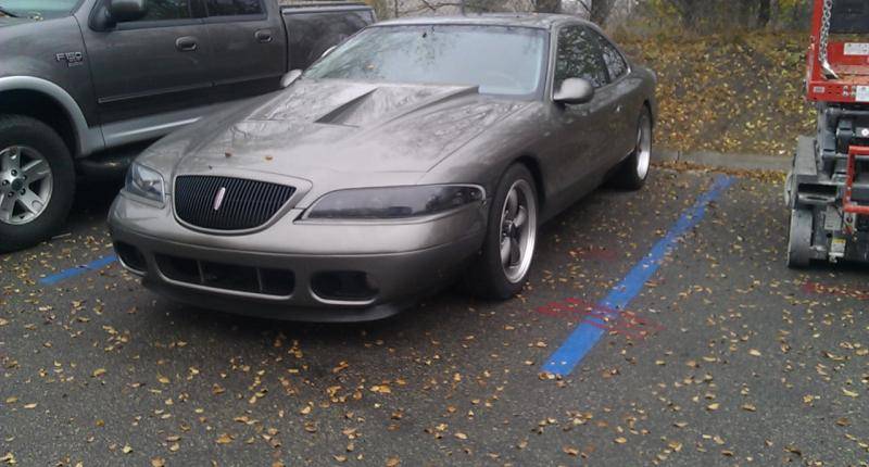

Ohhhhhh....Myyyyyyyy........GAWD!!!!!!!!!!!!!!!!!!!!
:eek:
I'm speechless. I absolutely love it. If I saw that front end coming behind me in the rear view mirror I'd sh!t my pants!!! :D
What's the color code on your door? I'd love to paint my car in a darker version of your color.
The paint code is TT. They had 3 vairiants of that code; one that was more blue, one more green, and a darker version. Mine is the dark version with a mid coat of gun metal pearl. With the mid coat it looks gun metal in the sunlight, in the shadows or when the sun goes down its dark pewter.

WOW! That bumper and color with the smoked headlights and blacked out grill look really really good together. Not sure but I think maybe I would like the basic cowl hood better.
Thanks Don, the hood is actually functional too.
The heat extractor vent are open just behind the radiator and the cowl vent runs the length of hood down the center to just forward of the alternator. When I install the SC instead of running the intake out the passenger side I'll run it to the center and pick up the cold air from the cowl. That's the plan anyway.
The headlights are clear but with the housings painted flat black inside it makes them look blacked out, I almost painted the housing the same color as the body.. glad I didn't now.

everything is ****ing awsome about this car except for the ugly hood...i dont like it...you should of done something like the 94-98 Cobra hoods.

That's badass man..I really like the 03-04 cobra extractors on the hood, just not.really a fan of the cowl portion towards the back..looks too sharp and squared for the gen 2..but hey just my opinion, if you're happy that's all that counts..overall really awsome work..love the headlights and custom neon err LED center light...are those staggered 17" bullitts in the front and 18"s in the rear? or all 17s?

Those are 18" bullitts all around, staggered.
Pictures don't really do the car justice from a color/lines, it does look pretty mean in person.
When I made the mold of the top of the hood I did it to the inside of the existing step in the hood. If you look at the stock that step is quite wide at the rear and narrow at the front. That Bering said I wanted to have enough room for the extractors while keeping so
me continuity from a ratio standpoint. I could have rounded the edges/corners more but would have sacrificed overall form/function.
Everyone has their own taste. I wanted a terminator style hood and it works.
I drove it to work with the cowl and vents taped off and home with the tape removed 2* difference in the outside temp and 48* cooler under the hood.
When the new motor and SC goes in that will make a difference.
