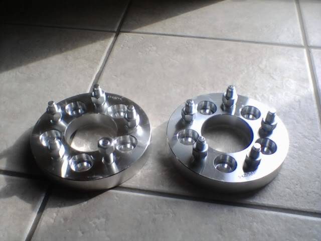

For the rear, I picked up a set of bolt pattern conversion spacers from EZaccessory.com that are 1" thick. They shippied to me in less than 2 days. Installing them was a learning process, sort of, on the best way to cut what.
-I ended up cuttting the original studs from the end and 2-3 threads.
-I left the lug nuts on all the way so that when I was done cutting, removing the nut would help re-thread the stud.
-The lugnuts still stuck out since I went with the 1" spacers. So, I cut of a little bit of the end of the lug nuts so that they would be at least flush or lower. I torqued these down to 98 ft/lbs.

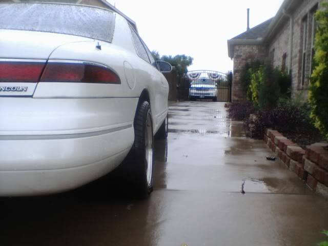

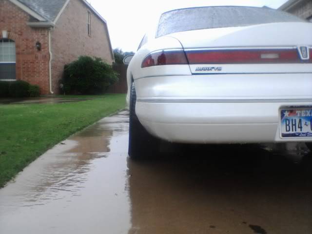

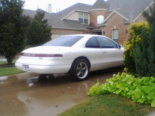

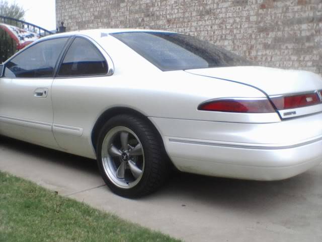

Bolted the wheels up, and they look great. They do stick out a tad, but it looks aggressive, so I am fine with that. Hell, I had 255/50/16 tires on stock snowflakes, so this is no big deal. Overall, I am very happy with this mod, and I did not need to buy new tires. These are size 245/45/17. Cost of the spacers were around $90 shipped. I can do a full write up if people are interested, with pics. Also, I used a 4" cutoff wheel powered by and 80gallon air compressor. Made everything go a lot faster. Thanks for reading, and sorry for the crap pics, I used my phone and it was raining/tornado-ing.
This picture makes them look like they are out really far, it is just the angle, they are not too bad.

it will also look a little nicer when they are moved in about an inch
also get some real lug nuts I am guessing you already planed on that though

I have the bullit wheels on my 96 and just love them.They are color coded to the car and look sweeeeeet.The hub swap is a must and in my opinion safer not to mention sticking the tire back up under the wheel well.Then you will probably want the bigger cobra brakes on the back so the stock hub change is a must.JMO
Welcome to the texas club. I'm in irving. Seem like dfw mark guy leave and a new owner replaces the ones that leave. Look good 'cept the rear skinny tires.
