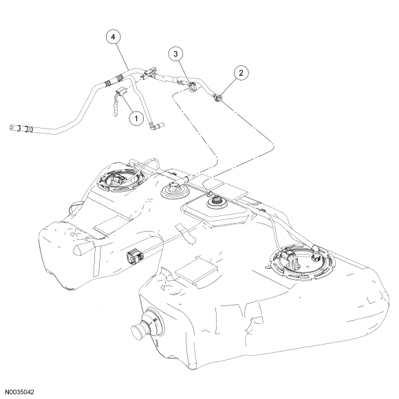

My best guess (and it is just a guess) is that the sensor is part of the emissions canister. It looks like you have to drop the rear subframe to get to it. Hope I am wrong.
Edit: I am wrong.
Never mind. I found it.
The connector for the pressure sensor is #1 above.
Unfortunately, this is even worse as you have to drop the fuel tank.

So the manual says. Maybe the transmission guy wasn't so crazy. I wonder if you could cut out a few access holes under the seat to get to it, then rivet some plates back over them?

So that sensor is on the drivers side of the car correct or am I looking at that diagram backwards ?
Yes, that's the way it looks to me too (driver's side).
