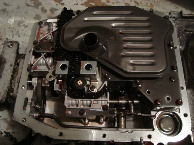

Not sure what the part numbers are but if you call Maxx, he could tell you or they'll know what you're talking about if you'll just explain that you need the updated accumulator and springs. I think getting a new shift control solenoid would be a wise choice too. It's under the pan and the accumulator and springs are too.
Shift control solenoid
getimage.php
small hint at the bottom right of this pic above.
Bottom right of the pic below you'll see a round spot. That's where the 1-2 accumulator is. You'll have space to put a C-clamp on that to compress it while you remove the retainer ring that holds it in place. The springs you get should be blue and purple and a new updated piston.
