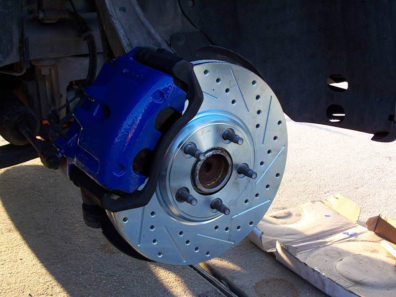

Well yesterday I put a set of cross-drilled and slotted rotor, new pads and painted the callipers. I had to let the calipers dry for 24 hour. Today I took it for a drive and it sounds like SH!T. The brakes are rubbing constatly on the rotors. Is this suppose to happen? Are the slots on the rotors suppose to rotate in a certain direction? Any help would be greatly appreciated. I will not drive the car if it continues to sound so horrible. Thanks in advance.
yes - the slots are directional.
Did you cut the front and back edges of the brake pads on an angle? Some pads come that way - while many (especially performance pads) do not - expecting you to do it as part of the installation.
if you didn't the sharp leading edge may be catching the edge of the slots...
You'll love this one. So I take all the wheels off the car and start looking for something out of the ordinary. Turns out that on the driver-side front I had bent the brake dust sheild. It was rubbing on the rotor making the loudest noise. Just thought everyone would get a kick out of that story. Thanks for the help.
