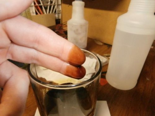

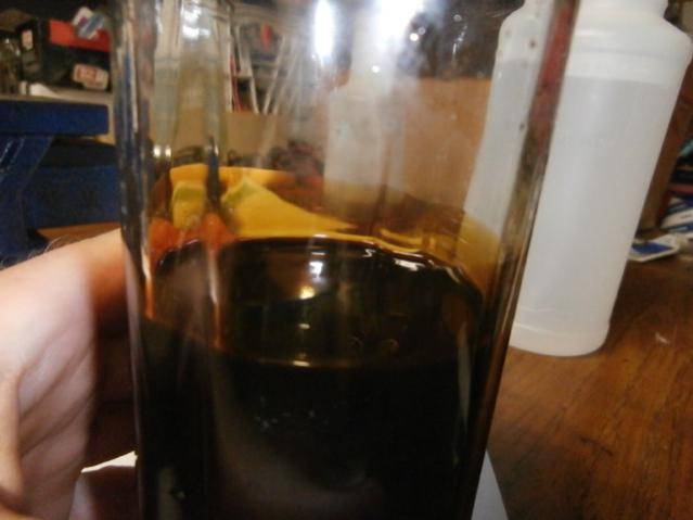

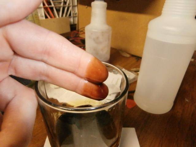

had some time yesterday so i drained about 12 ounces of oil (came out medium to dark brown after 2900 miles :-(
then ran a bottle of Sea_foam through the crankcase for 3 minutes, then drained and refilled w/ Mobil1 0w-30 full synthetic and a new MC filter. The clackety clack on startup is not gone, but the engine may sound better overall, time will tell

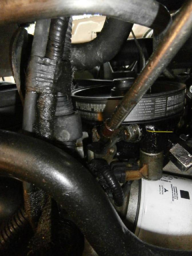

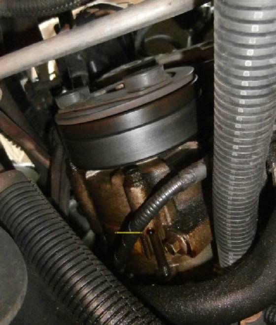

also noticed some mess underneath:
on the pass side, a/c compressor
and this leak at the PS hp line/pump which I've know about for a while now
could the oil on the bottom of the a/c comp be originating from the PS leak?
-to remove that PS line and replace teflon washer do I need to remove the pulley? for the life of me I cannot get a wrench on that nut
here's some of the oil drained yesterday..5w20...darker than I had hoped....just turned 118k
