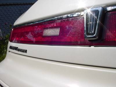

Yesterday I was extremely bored, so I thought Id take a stab at refinishing my trunk lock cover. I got it off, sanded it and then painted the back side black. Tell me what you think.

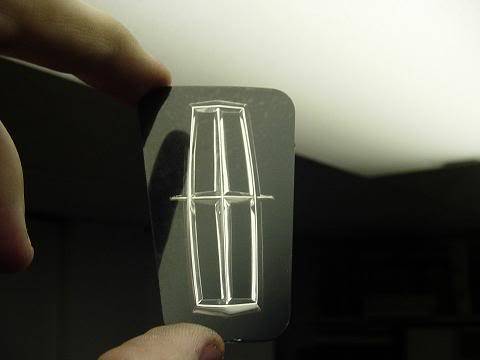

MarkVIII93 said:First I removed the carpet covering the nuts that hold the tailight assembly on, then I removed the nuts themselves, then there are 2 small screws that hold the center trunk lock cover onto the tail light assembly.. I removed those. Then there is a small hole in the back side of the trunk lock cover, which i decided to wrap a small screw driver with tape and pop the plastic piece out. Its a lot less complex than it seems. Hey Msm8stress! I have an extra one sitting right next to me. I can send it to you free via US mail. All you will have to do is remove the tail lights, then the TL cover.

Well, when you pop the plastic piece out. The lincoln star is engraved I guess you could say, into the back side. All I do is sand everywhere BUT the star is. And it comes out that the surrounding is clear and the star is still chrome because the back side of the paint hasnt been touched. Then you sand the backside clear part with higher grit sp. Then you wipe the surface down with an adhesive cleaner/remover. I just used "trim black" paint. Made by SEM. The pictures dont do justice, you must see this piece in person.Dawkins said:how did u guys paint the center inside peice inside the chrome lincoln symbol black...mines red and after grinding it done theres no way 2 get to it?...

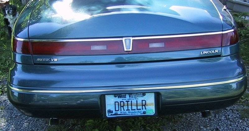

I used somaco brand 88r silicone construction sealant. It doesnt effect the paint what so ever.driller said:That actually looks better than mine!![]()
When you put it back on, what did you use? I used 3M trim adhesive which reacted slightly with the freshly painted backside.
Yeah, Just sand everywhere except for where the star is until the red goes away. If you havent even started yet... You have to get the adhesive off the back first, Then sand it down.Dawkins said:So what your saying so u just sandpaper the whole back peice except for the groves where the star is and it will take my red flake away?

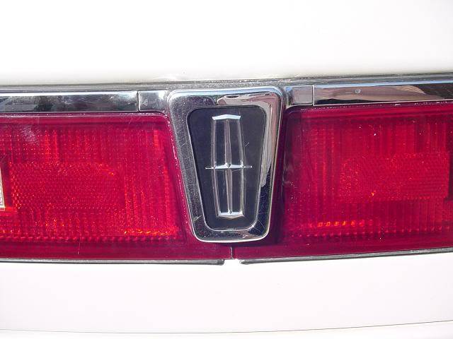

fat star?ONEBADMK8 said:I think it looks great. I am just not a fan of the old style "fat" star. Thats why I did mine custom.
ONEBADMK8 said:The Lincoln "star" is FAT as hell on the Marks. Heres mine.
Ill be doing these with our CobraStar logo soon.
