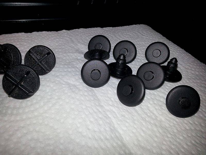

What do you call those clips so I can look them up on ebay
Ford plastic retainer clips
Boat load of different one available .... up to you to find the correct ones.
