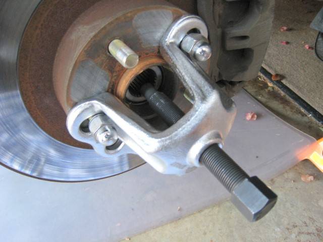

You'll need a puller. 3 jaw or one that attaches to the studs with you lugs
This thing is the ****. I think you can rent one for free at autozone
Or there's that too. My method always works for me
Yeh, that looks like a good idea - if you can't beat it, screw it! :shifty:

Whenever I hit a situation like this, I could use that crank puller/press tool you have pictured, crank it down tight enough so there is a lot of pressure (but not tight enough to break it), then whack it with a heavy hammer while the pressure is applied.
That always works with anything (works good with ball joints too) and is the best solution short of cutting it all off with a cutting torch.
