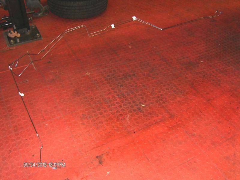

I ordered and received 3 sets of rear lines @ $210 + shipping per set.
I opened the box today and took a look at what I bought.
The lines appear to be correct and nicely made. I'll know for sure once I've installed the first set.
However, I was extremely disappointed to discover that while the lines are stainless steel, the fittings are not. :mad:
Mine rusted out too. Instead of running the line to the right rear wheel up and over the rear end, my father and I spliced the line just in front of the door. You'll see a cross-member about a little more than half way the door's length. We ran the line along that cross member and right to the other side and into the caliper. So much easier!!!
