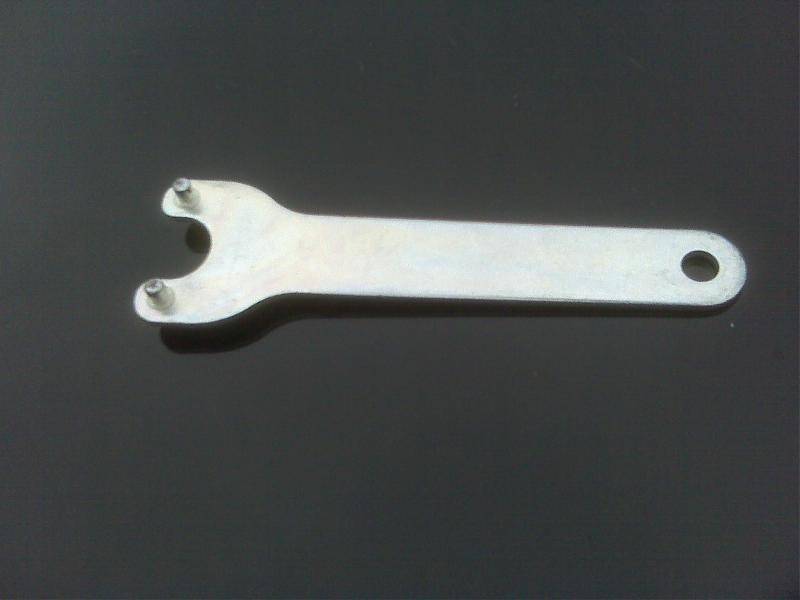

I used this tool for the rear brakes. It is used in a metal grinder, but works well on the LS.....
hey look my thread is back!
yea that tool looks ok if you dont have to apply any downward pressure. but if you do then its not gonna work to well.
