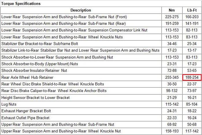

I think the spec was about 30 lbs of torque.
:confused: :eek:
Really? Thought it was 221? I cant seem to find my manual CD but I am pretty sure it was that or 300.
It's possible that the torque spec changed through the years. I'm just going by my 93 manual, which says 251.
I wont lie I gave it some good torque, info needs to be accurate though. Pop the cap off the rim and its right there as well.
That comment was directed at the OP, not you. You posted while I was trying to find my repair CD and I didnt see your post before I posted. Which is why I made the second post ya dang Britt! :fuss:
No worries - turns out we were both in the correct torque range anyway. :)
