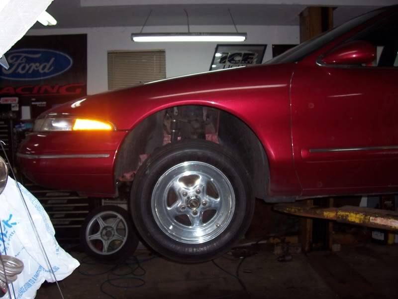

Yes adapter on front ONLY, to mount my 15 inch front runners on. Not on the rear because I want to run 8 inch wide rim with 5.5 back spacing and not have it stick out past wheel well. In pics you can see that these are in as far as can be with 15 inch rim.

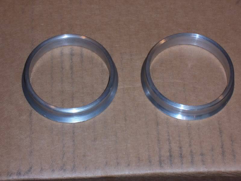

I make these. They are for my 2000 GT rims. I don't like plastic like all the store bought ones are. Sloppy fit and soft. When I run the Welds I don't use hub rings because the str8 shanks hold it and nothing will change that.
It's really simple, just smack them once or twice with a small hammer.

Rings can vary with rims. The one dia that stays the same is the ID of ring because that's the cars hub and never changes. The rim maker can make the ID of their rims any size they want. So you have to know the ID of your rims to find out what rings you need. I use the rings on all my STREET rims. The Weld rims are drag rims and the lug shanks hold rim concentric.
