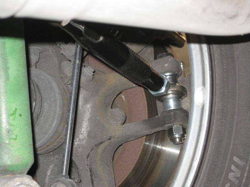

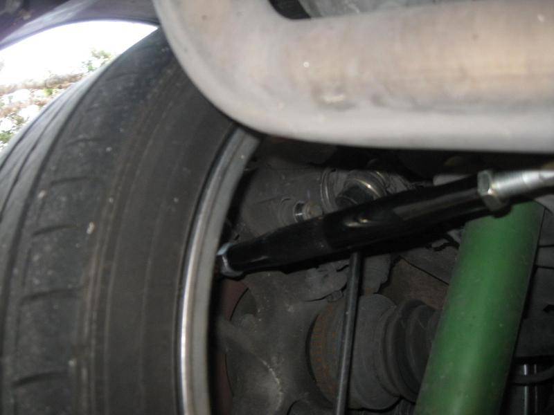

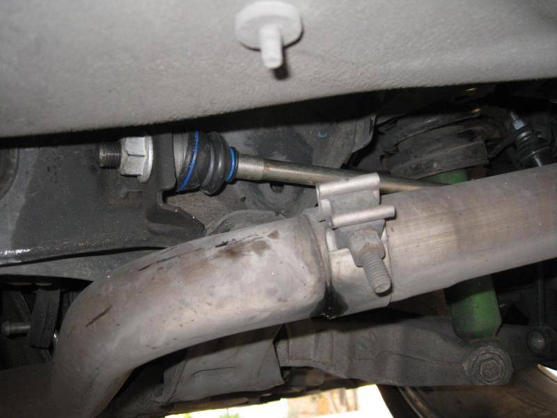

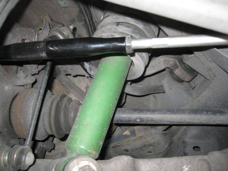

I have been wanting to post a few images of the Custom Toe Rods built up and installed.
Here ya go.
