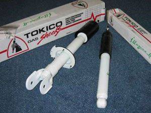

I'm still tempted to try these electronic adjustable Tokica's. Best price I've found is on ebay for $133. The Blisteins are $111, so for $22 more a shock USD, then two SC actuators (I think the M8 and SC actuators are the same), maybe even the TC actuators are the same, easy to confirm they work anyway. Then a switch to activate actuators. I will have to check the wiring diagram to see what makes them move from soft to firm and replicate it. Might be easier to get the ARC (Adjustable Ride Control) module and wire it in.
Just trying to sort the front adjustable dampening. The SC front Tokica looks like you could almost add the air bag to it...well from this pic anyway.
That's what I like about the M7. The air bags and shocks are separate. Not one complete unit as the front shocks in the M8. Piece of cake to install TC PRC (Programmed Ride Control) into a M7. Then have the best of both worlds. A sweet soft ride and a firm mode for sport driving at the touch of a button.
