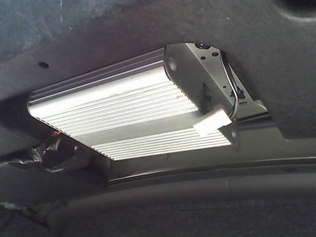

Well I did my search but didn't find my answer.
My rear speakers will "whine" almost annoyingly "drone" with the rise and fall of the RPM's. It's SO bad that I had to turn off the radio. All media's whine (CD, Radio, Tape).
Well an audio guy told me I have a loose ground wire, or to replace my spark plugs.
So I actually resorted to pulling the plug harness from the rear speaker amp, if this is what it is?
AND the "whine" STOPPED. So do I have a bad amp?
And ideas here or what to look for?

I plugged the AMP back in tonight and it hasn't whinned at all. So I'm thinking it's a ground wire. I will take a look at the COPPER wire looped/weaved wiring and see if something is touching or needs to be insulated.
I hope to replicate the problem tomorrow. I did go to Radio Shack today and the Ground Loop they had will not simply PLUG into the factory amp with it's connectors.
just a thought, but have you tried measuring the resistance of the ground wire to the frame of the car?
