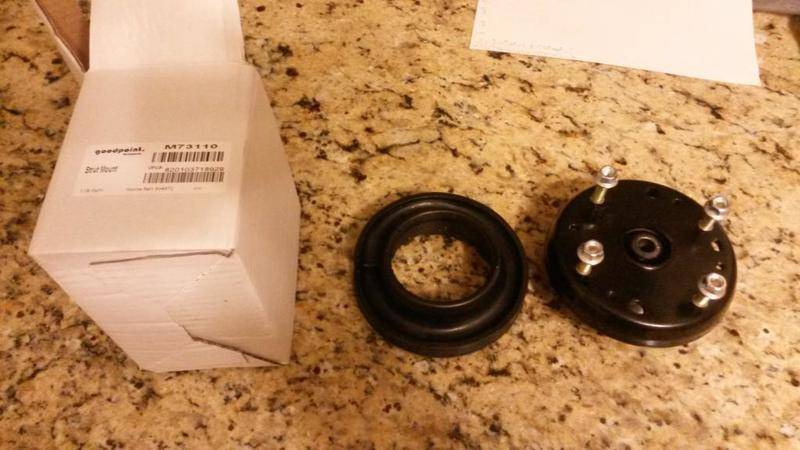

1. Shock Tops. SENSEN Part # M73110 Shocks and Struts 20.79 each from RockAuto. Im a cheap bastard so I went with the cheapest after I verified it came with the rubber part and the bearing. Also new nuts.

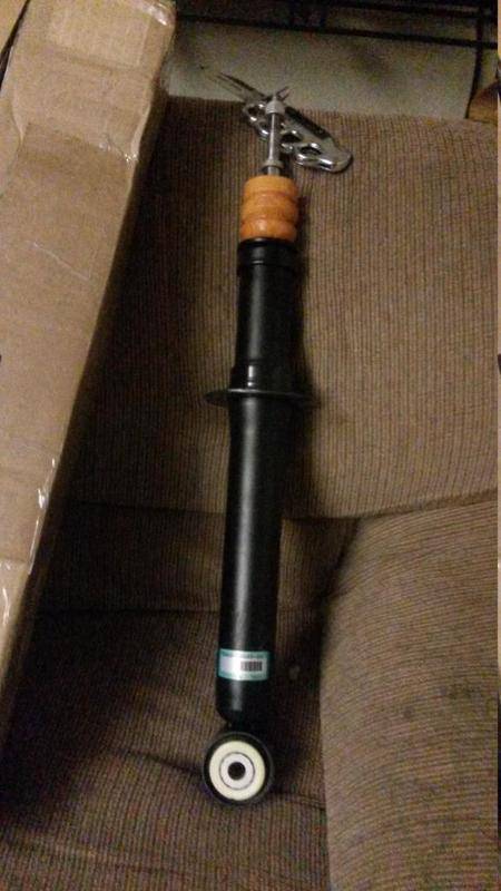

2. Front Shocks. Appears to be very few of these left....Notice it came with the rubber cushion part and the top nut. Also notice the Green label.
Im a little ticked off at myself.

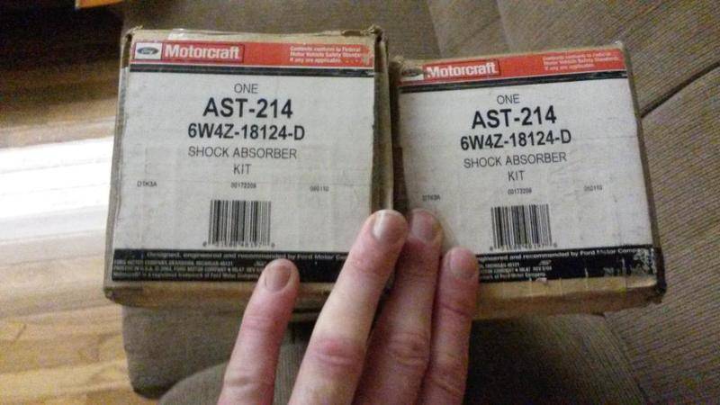

I didn't notice that these shocks are available on rockauto...listed under 06 only. for only 85 bucks a piece. I paid about 120.
I only figured it out because I typed in the 6w4z-18124-D number into google.....Frustrating...but maybe this will help save another a few bucks. (Im still standing by that dealer treating me pretty well)

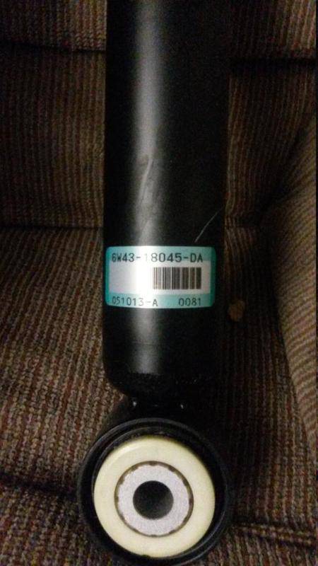

The 6w43-18045-da number found on the shock label only returned hits back to this forum. Wanted to list it here again for future surfers looking for info. Allows ppl to either sort more crap out or be more confused..haha
