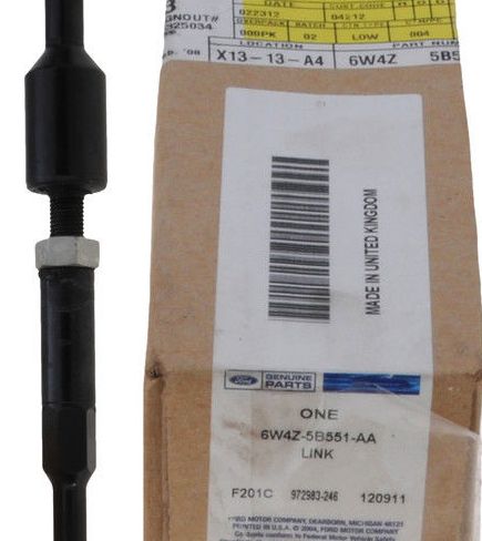

"Genuine OE Factory Original Item" ... Ain't that a bitch!
LINCOLN OEM 6W4Z-5B551-AA ~ US $118.35
Many available: http://www.ebay.com/itm/like/221378388214
More: https://www.google.ca/webhp?source=...JU_SlJsiD8Qe6hIAI#q=Lincoln+Part#+6W4Z5B551AA
^ Yup, but it was all about retaining the Passive Steering with the dampener on the OE part. None were to be had for a while.
Discussion proved it wasn't that big of a deal and many, including myself opted for the JAG DEEZA JA-L607 linkage.

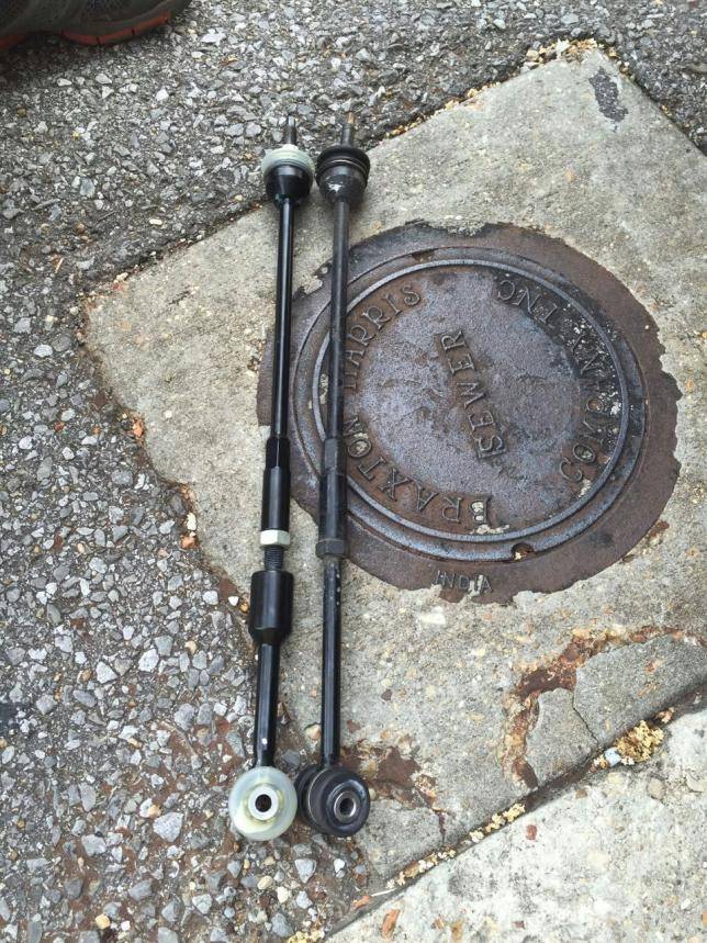

Second this. Never ever buy these eBay ones named "deutsche parts". I've got a pair of them this January and put them on this March. After less than 1000 miles my car starts to sway on highway, both left and right! At first I though it was alignment/suspension problem so I changed all four struts and front control arms and outer tie rods. Still the problem does not get fixed.
Then I found out the problem was when I release the gas at high speed (>50) the car starts to sway. It sways to both sides so probably not an alignment problem. Also when I am accelerating there is no such issue. At first I thought it could be around the front part because when the car slows down all weight shifts forward. Then I had a mechanic at a local shop to take a look at this. He said he has never seen this in his life. He raised the car and found out the problem was these rear toe links. It has way too much room to play for the rear toe angles on both sides.
Today I have put a pair of new OEM parts on and now it runs perfect. The removed one are really busted although they look good from outside. I can even pull it with my hands so it extends. That explains why the rear tires wobble when off the ground. Plus part of the piece inside the boot at outboard side is also exposed, meaning the boot sealing is already bad. I took some pictures.
Anyway, now I am fighting against those sellers on eBay. They are only willing to give me their "store credit" but apparently I will never by anything from them. This is no difference than suicide. IMG_20150809_114018.jpg
so I bought a pair of these (Ebay ones) last year, I wanted to get oem, but i was having trouble finding a place that had a pair in stock, so i would wait a couple of weeks and check again. after not wasting to wait any more, i gave in and ordered them.
after putting them on, my car became dangerously loose, and the rear end would just try to jump out around the car, i used the old ones i took out to get the new ones close enough to get to the alignment shop. if the advancetrac was left on, the car would freak out when turning even slow from a dead stop.
the shop gave it an alignment, and during the test drive, they noticed the same thing. turns out both parts were defective and allowed way too much movement at the expended section. i can see one bad part, but getting two just shows how poor the parts are.
didnt feel like waiting any longer so i ordered the Deeza parts (got an email that the OEM parts came back in stock a couple of days after ordering, go figure), they went on without a problem and have worked great for the couple thousand miles since.
Anyway, now I am fighting against those sellers on eBay. They are only willing to give me their "store credit" but apparently I will never by anything from them. This is no difference than suicide. View attachment 828473345
I think ed was saying to stay away from the Deutche parts because they are junk
Yeah I got that about deutsche=junk. Guess thats why they're cheap.
But my question was how do I tell if the toe link has passive steering or not?
It's all in that fat knot on the rod at the bushing end, that's where the passive steering effect happens.
