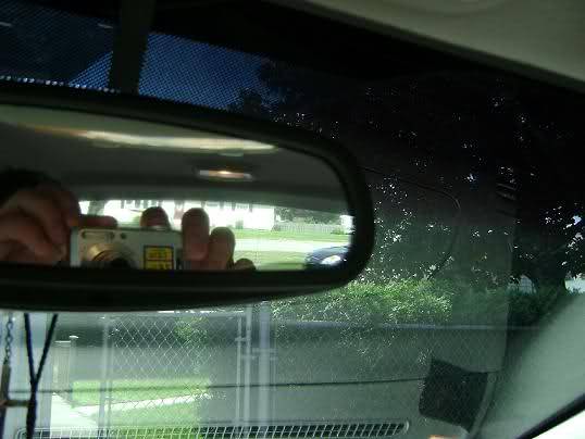

Ok guys, so i pick up my car at Ford today and i get in and i notice black drops of like oil on my center console, including on the wood grain.. So i yell at ford and say what the hell is that bla bla bla, they didnt know, they cleaned it up and found out that the mirror is leaking some type of black liquid, my mirror has a black spot on the bottom left and bottom right, at first they said it was the windshield, because i got it replaced a few months ago, but i inspected and found no sign of liquid from anywhere on the windshield, so i think its just the mirror itself, i got a 2000 LS, no compass on the mirror, the mirror right now its blurry .. oh, and i do have a 12' sub in the trunk, and sometimes i crank it up a lot and the mirror shakes like crazy, maybe i did something to it ...
Cant really tell, but the black spot in on the bottom right ..
So question is, does the mirror have some type of liquid inside of it?

+1 on the liquid involved with the auto dimming mirror.
Damnit .. lol, thanks guys, I have to get the same auto dimming, i dont want to do any additional wiring
just 3 days ago i ripped mine apart theres 2 peices of glass put together 1 clear glass and 1 mirror with brown liquid in it / i put back the mirror part cleaned it up and put it back together/ my rear window is tinted so it works perfect

Yea sounds like that auto-dimming liquid to me...I busted my mirror with 2 15" speakers...it doesn't leak but it is always dim like it is tinted...I need to get one...I think LSKoncepts sells rear view mirrors...check it out...good luck
By the way, that fluid eats paint worse than brake fluid, be careful where it lands. Happens on Audi's all the time. This is all assuming it's about the same stuff, I dont want to be the one to find out though.
it got 2 tiny drops on my wood grain, took it out, chipped the wood a little bit, got it near the shifter, 3 medium sized drops, took it out, chipped that too, that crap is ridiculous.
I have a little rag near the shifter incase it decides to drip again, it doesnt harm anything else in the car.
