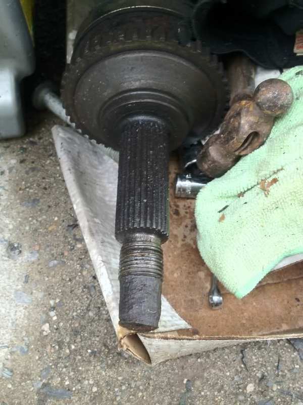

Not sure you're still active here but were your threads on the axle completely rusted away? I'm about to do this but am afraid I have to buy new axles because the threads are completely rusted away. Since new axles are $240 and $270 each, I'm entertaining the autozone re-manufactured route for $65 each.
even if your threads look rusted away, you can still get the axle nut off. The part of the axle bolt closest to you that looks rusted away doesn't get threaded when you take off the nut.
I just heated the :q:q:q:q out of the bolt and broke it loose with a breaker bar.

I bent over and did the ankle grab, though still got out cheaper than new knuckles. Ordered new axle assy's for both sides plus the nuts. I'll have them there as backup in case the old stuff is not good enough to reuse. I find it hard to believe that it would be reusable though. The thought of an autozone reman handling 400 ft-lbs of torque made me cringe a little. Who knows what was wrong with them and if they're truely in good shape. While the parts are in shipping, I've been spraying the axle and nut with WD-40 for the past couple days hoping it will make removal a little easier. Also got some Euro shocks for rear while I'm back there.

02 Linc I promise you, no matter what the end of your axle bolt looks like, if you get a pep-boys blow torch and a breaker bar your axle nuts will come off like butter in under 5 mins.
soak em up the night before with PB blaster, then heat the nut up for 5 mins (off and on getting it a lil red) and she'll break loose

here's what mine looks like
Holy f-bomb!
And yeah, I used a pair of autozone remans for $55 or so last year, no problems.
Use lots of anti-seize on the splines. I had to remove an axle for a knuckle change and in one year, the thing was hard to get back out again. I used a push tool from autozone, worked like a charm but it did build a lot of pressure on the pushing while it was working the one year installed axle back out.
Holy crap. Did you reuse the axle? I'd be a little apprehensive after heating it that much. I plan to take my axles out anyway for the traction loc install. Should make removing the knuckle easier.
