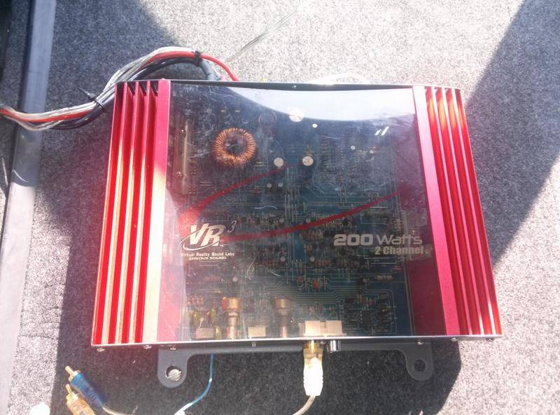

Aftermarket AMP?

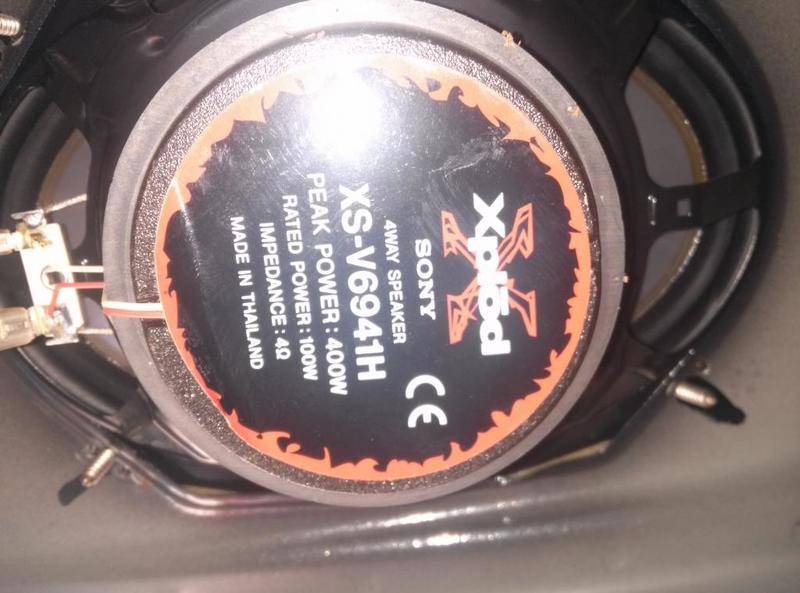

and blown 6x8
Yes 6x8 in all doors rear package tray are 6x9 mid woofers.
Yes those are aftermarket sony xplod
The 2000 model ls can with a sub enclosure that houses 6x8 midwoofers
If the the Sony xplods that's in there now are 6x8 then yes they will fit in all doors.

Crawled in my trunk and looked up the model Number on the speaker and it is a 6x9 so i am a little more inclined to replace them. Now to find instructions on removing the trim to get to them. Off to goolge

I have no idea. you guys probably can tell more than i can by looking at the pic. All I know is its an amp with 200 watts and 2 channels
cant see the model number, that will be your best bet to figure out what its real power is.
heres the simple break down, most amps that list the power right on them, list max power (no where near real power) and a lot of the time its not too accurate...
but if its a two channel and it outputs 200 watts max, thats bridged so each channel is running 100 W max @ 2ohm so for normal speakers (4 ohm) its probably about 50 W max which at best is 15-25 watts RMS (real power) but just for reference, quoted from the pyle website

you can also get a good guess by what size fuse it requires. take that number, multiply it by the cars voltage (12-14) and that would be the theoretical maximum RMS power output IF the amp was 100% efficient (its not), at best its 90%, at worst its 50% or lower. if when running the amp hard it stays very cool to the touch, its very efficient, if it gets hot, its very inefficient.
