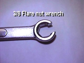

flare nut wrench is kind of special.

Car hard line has to thread into the hose on frame. So yes.
eh, I just removed my old (oem) hoses and put the new ones in place...unscrewed the old from the hard line and screwed the new one on...no flaring....did i overlook something? they're not leaking, nor am I driving the car yet
I call them line wrenches, they look like this. Nothing to do with flaring per say.
Flare wrench is not a flaring tool. Flare wrench is a wrench that looks like a box end but a slit in it so it can go over brake line and grab tube nut real well.
