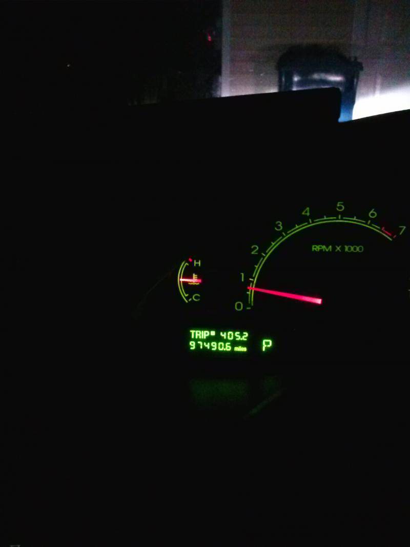

Anyhow, update. Finally finished the LS last night. Me and my son took her for a good cruise. I don't know if it's just my paranoia at the moment, but is my temp gauge normal? It seems like it might be a hair over perfectly horizontal, but it may be my imagination too.
Normal. That's where both of mine stay.

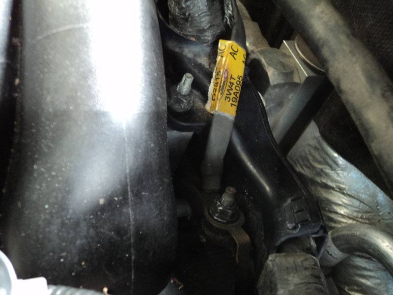

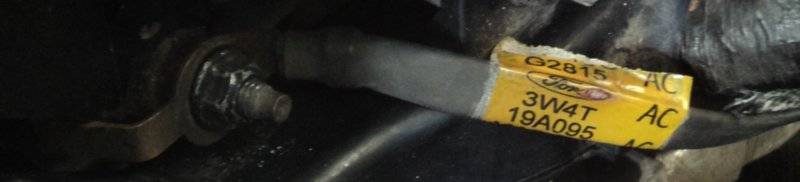

I did a search for 19A095 and page 3 of this comes up.

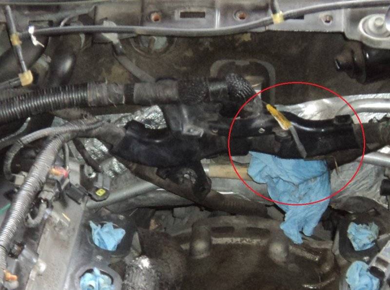

This is mine AFTER overhaul and bleeding done.
Coolant overhaul done (many struggles! ha), by-the-book bled, 30 miles on it, no leaks, huge sigh of relief!!!
This maybe belongs in a different thread but I did the entire fill/bleed process, engine running, all the while without this 19A095 ground wire hooked up. It was clicking and missing as if bad coil(s) and/or injectors (it didn't do this previously; I was puzzled but proceeded).
Bleeding done, I then looked around and found the ground hanging in back of main harness junction plastic. Just great. Would I have done damage with it running like this for about 15 minutes?
With ground attached, where it belongs!,, it ran much more smoothly, no clicking sound, yet still as if one bad COP.
As a side note btw, with IM out, I DID change the spark plugs (platinum AGSP32FSM). RH side went quickly although I didn't test each coil. LH side went slower, but I did test each coil and the 4 tested good. BUT on each side 1 or 2 COPs seemed to go in as if not seating onto the plug real good - a bit too easily (I did use dielectric).
Back to the main question: coolant system replaced, new IM gaskets, torqued by the book, new spark plugs, bleeding and idling 15 minutes . . . ground wire not attached. Did I damage anything by this?
