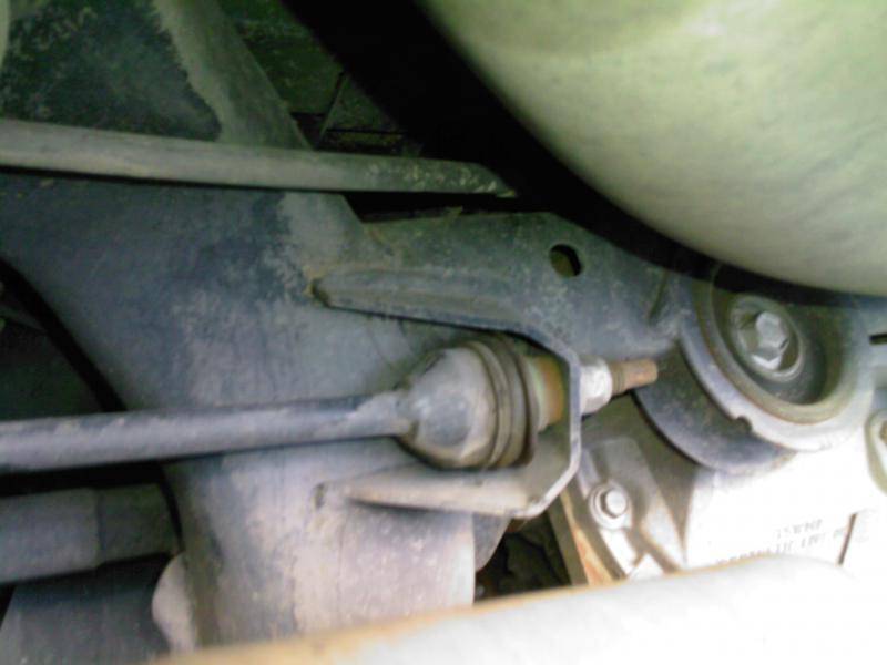

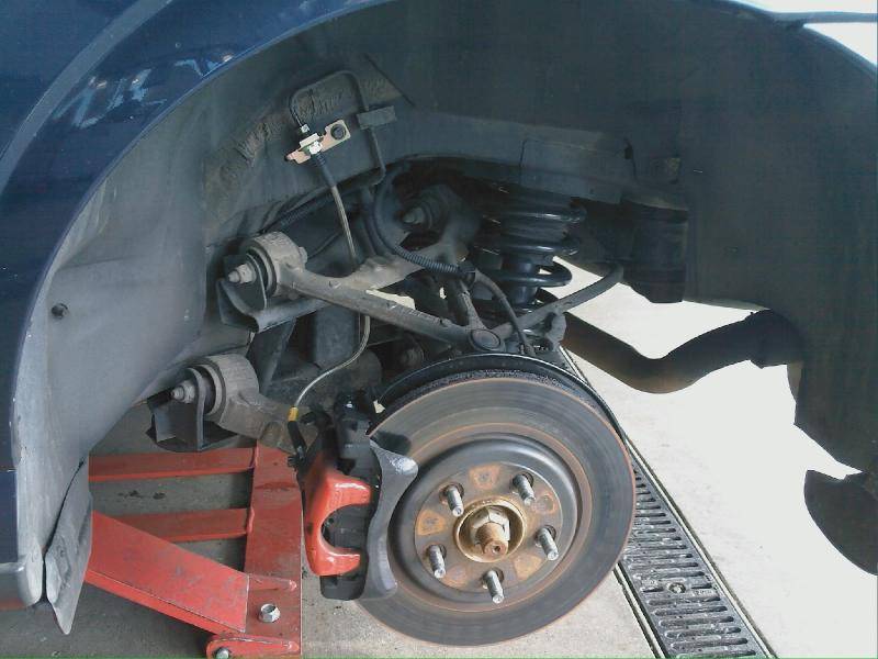

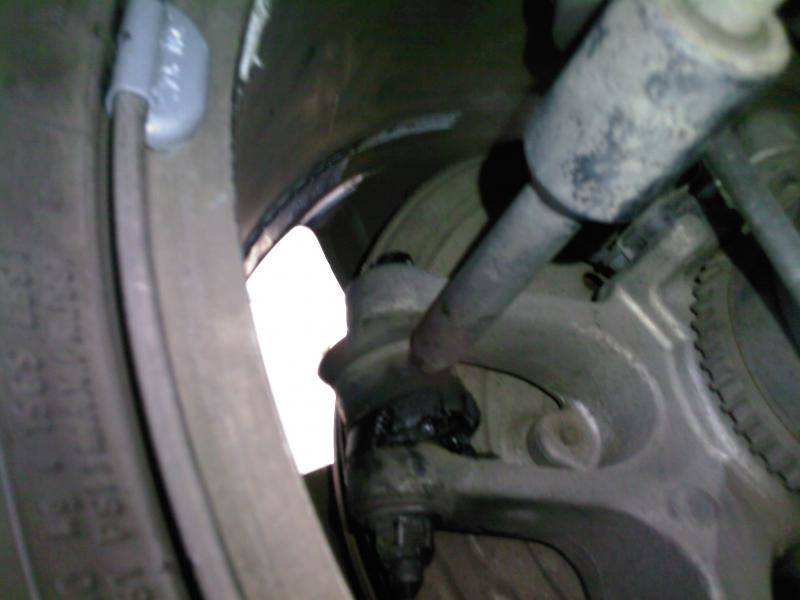

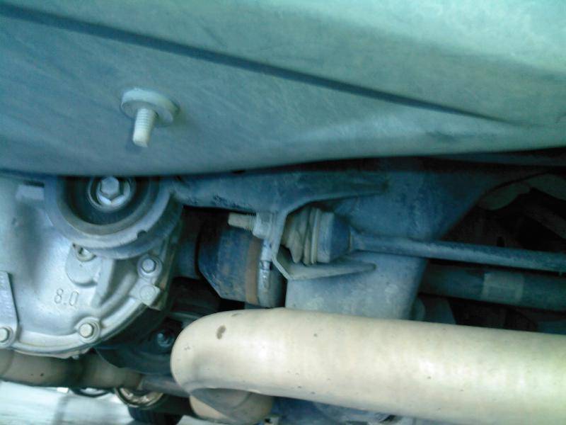

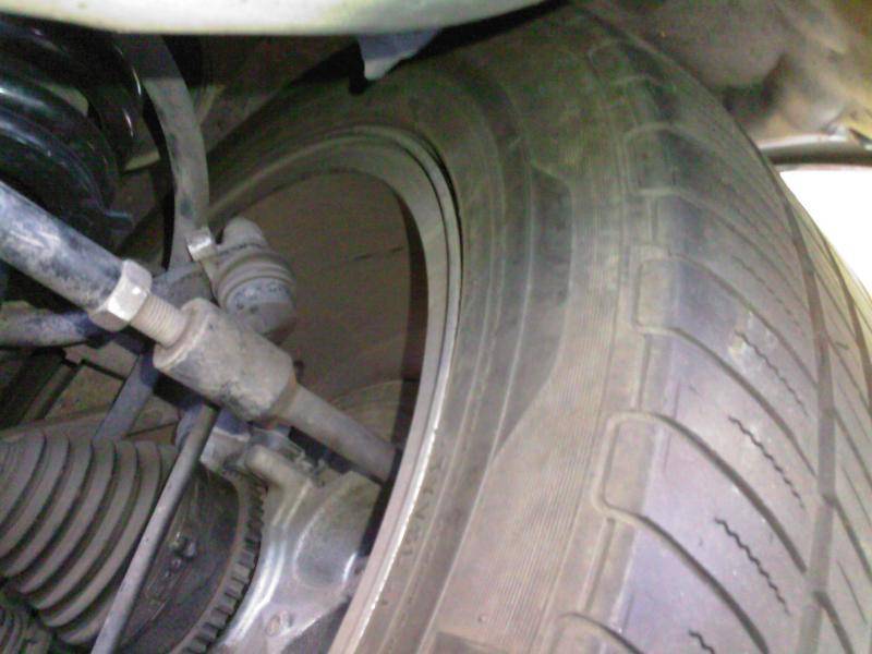

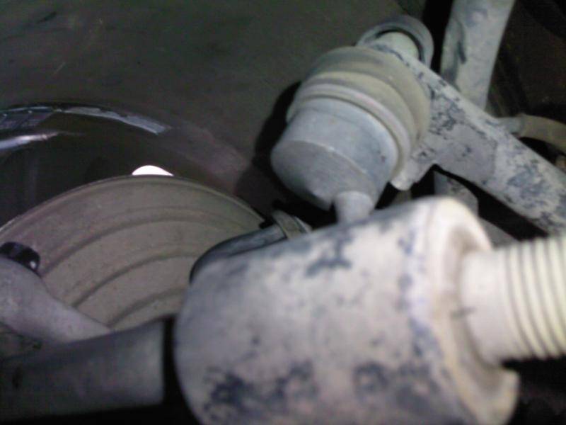

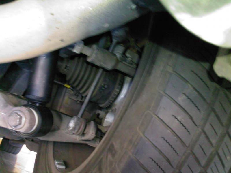

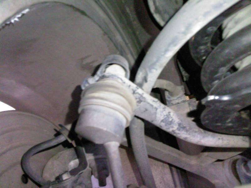

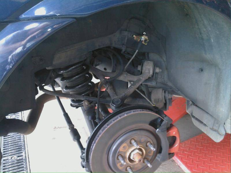

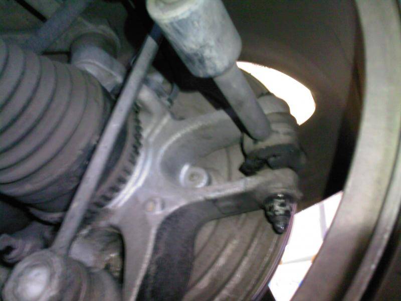

I snuck a couple pictures of each wheel well, anyone see any problem in there?
(New MotorCraft Sport Shocks, New Eibach Springs last week, new StopTech SS Brake Lines Monday this week).
Are the toe links OK? With the wheel off the ground, try to turn it in/out. Movement is bad.
Good catch, good point! I know the boots are torn.

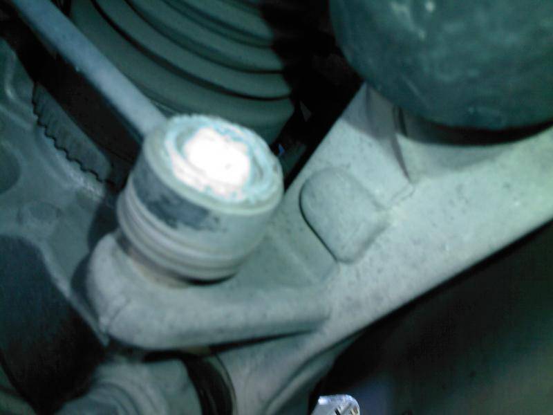

Toe Links look bad in these pics I just took.
Don't know if the Stabilizer Bar Links are bad...
Driver's side pics:
The true test is to try to move the wheel. It can look like absolute crap but still be tight. Anyone that did an alignment should have checked, as failed parts would prevent them from getting a proper alignment done. As a side note, it's usually good to get an alignment with a new set of tires.
Mine were all torn up, but still in good shape. They won't be forever - no boot means dirt gets in there, grease gets out, and it'll fail sooner rather than later.
That driver side outer end of the toe link looks very bad. It should be vertical - more like the passenger side, although that doesn't look all that great either.
The stabilizer bar links actually look fine. Same as with the toe link - try moving the stabilizer and see if the links move too much or make noise. If you do replace those, consider the Moogs, which have zerks.

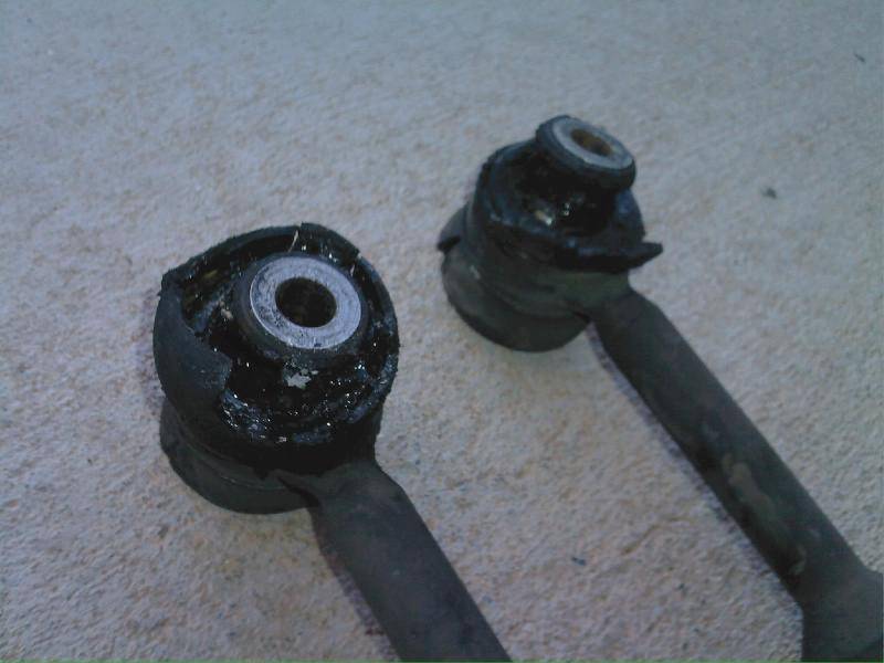

Pic of old Toe Links...
