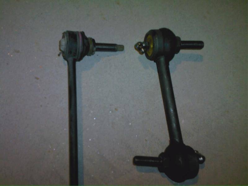

Here's the Motorcraft rear stabilizer link that came off on the left, and the Moog front stabilizer link that came off on the right. (Front and rear Motorcraft stabilizer links look identical in diameter... just longer on the rear). You can see the Moog's are beefier, with zerts.

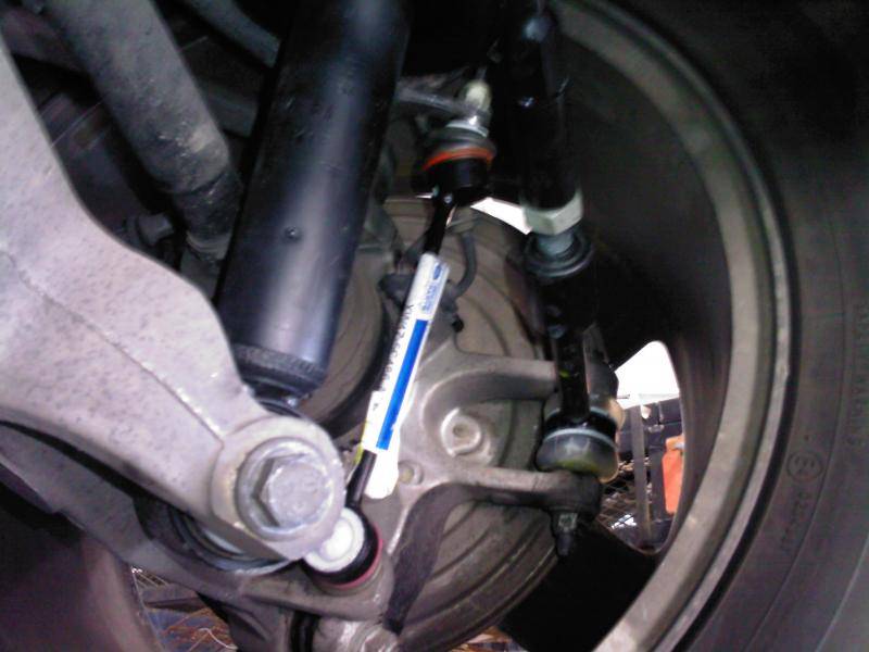

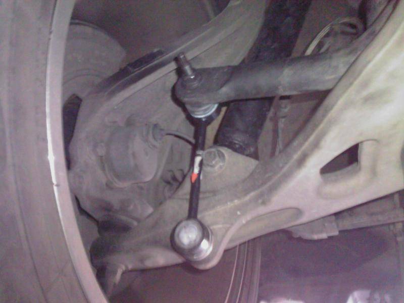

I got new Motorcraft front and rear Stabilizer Bar Links, and new rear Motorcraft Toe Links and had them all installed and an alignment today for $80 in labor (and they will install the ES sway bar bushings on the front for free tomorrow). The ride is much better, about 75% better.

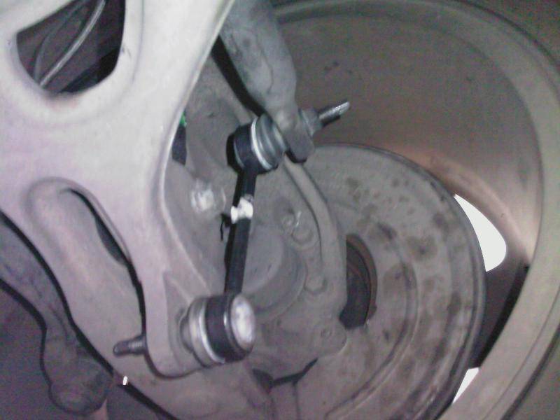

Pic of old Toe Links...
Pics of everything installed... Ride is much better after new Toe Links (stopped the swaying) and got even better after new Sway Bar Bushings today (better Left/Right steering response). Got another alignment today too. New tires Wednesday.
