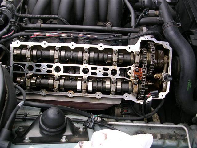

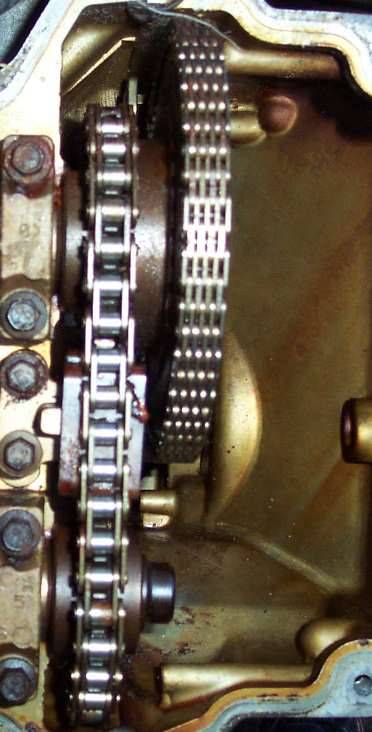

Notice the difference in the cams on the 4.0 and the 3.9. The flats on the Jag 4.0 are not the same as the (Ford) 3.9. There is an extra ridge (if you will) on the 3.9. Unfortunately on the Jag pic shown from your link the flats are not shown (engine in the wrong position). I think I have a pic showing the flats on the 4.0. (found it! it is pictured below)

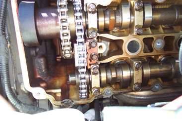

The 4 pics below show; the pic from your link, a pic I had from the Ebay seller (jag 4.0), my 2001 and 2002 3.9. They should be in order as described.
There is a difference between the 01 & 02 3.9 intake cam. Does anyone know why? I'm assuming it is for balance or dampening.

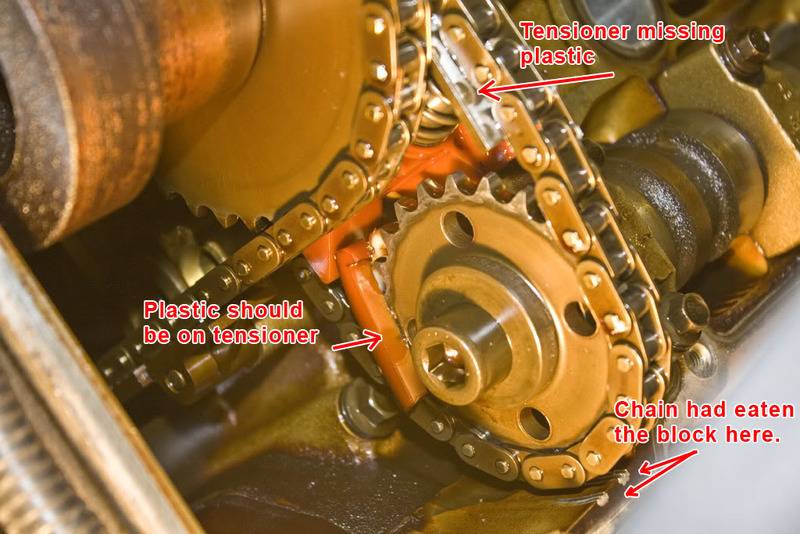

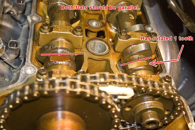

Here is where I am at the moment. Installed two new secondary tensioners, and noticed the left chain is stretched, and the cam is out of time.:eek:
Had to buy a chain breaker yesterday, so maybe today I can get the chain out.
This is the old tensioner and how bad it had gotten.
And here is how much the chain is stretched and cam out of time.
