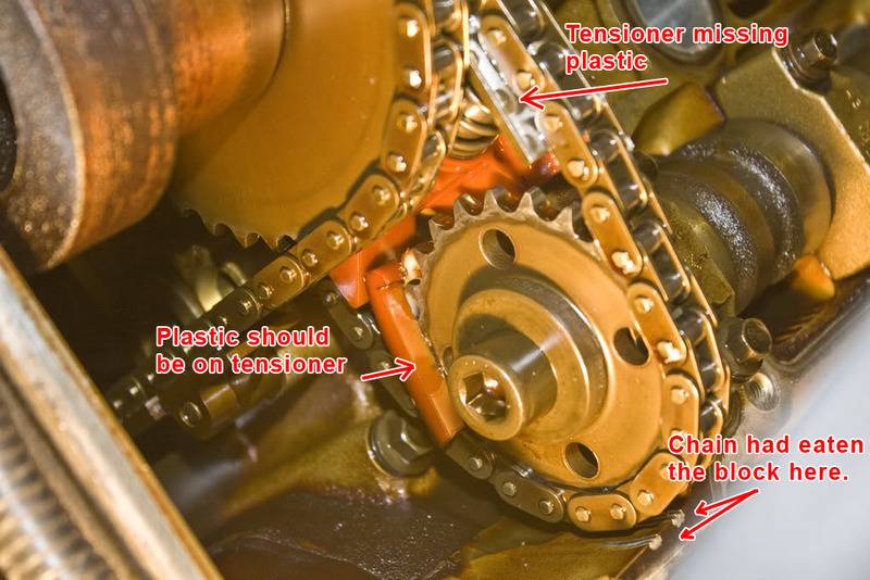

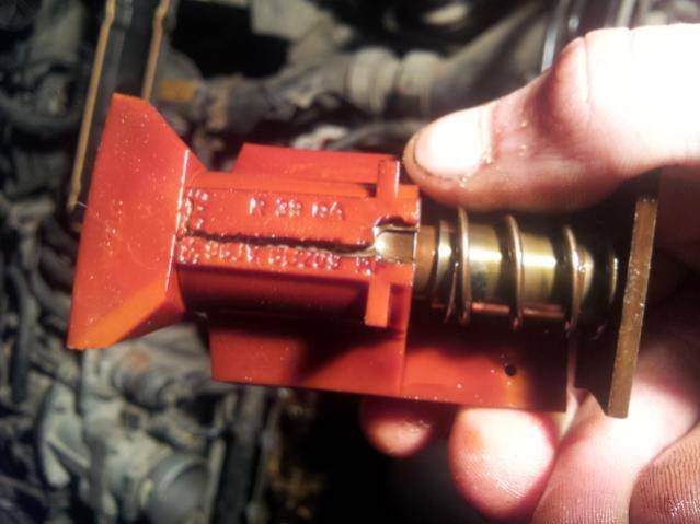

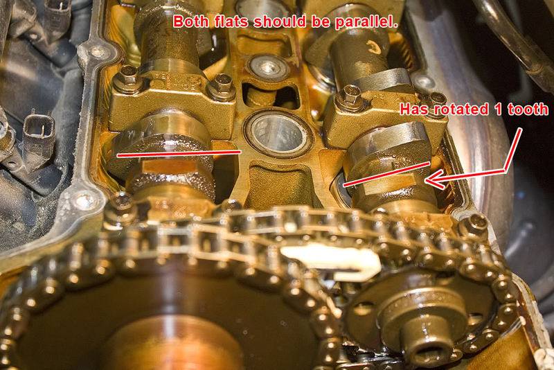

Here is where I am at the moment. Installed two new secondary tensioners, and noticed the left chain is stretched, and the cam is out of time.:eek:
Had to buy a chain breaker yesterday, so maybe today I can get the chain out.
This is the old tensioner and how bad it had gotten.
And here is how much the chain is stretched and cam out of time.

just another quick question, okay so clearly my secondary tensioner is dinked, but also, is my timing out? i kno with the tensioner out there is slack in the secondary chain, as shown in the image, but even when i apply tension, my cams arent parallel... they are close tho, i would think if it jumped a tooth it would be more out of wack! and last, does anyone kno the torque specs for the cam "bearings" or what ever they are called, not sure the specific name, also the pattern to tighten and torque-spec for the valve cover! any advice would be greatly appreciated!

You really have to check the cam flats with the chain tensioned. If the chain is not tight, then the flats won't ever line up properly.
How did it run before you took it apart? It certainly looks like it may have skipped a tooth. But it is hard to tell without being there.

deffinatly wish i had a second vehicle, so i could have waited on parts! and lmao!!! i dont kno how it ran! the whole bank 2 was misfiring other then clyinder 4, and rude slapping from the secondary chain, half the time she didnt wanna start, but when running and driving, ran great until under load at like a stop light or stop sign. mechanic who scooped it could not believe it was running

okay, so that being said, how do i kno which cam is either retard or advanced without having to tear down the other half of the motor lol!!! i gotta get this thing running by 2mor0, i would assume it would be the cam closest to the exhaust manifold...
yep, certainly sounds like the timing jumped.
im assuming that since my bank 1 is running strong, and the main bank 2 timing belt is run from the crank, to the intake cam on bank 2, chances are that one is fine, and its my exhaust cam that has altered positions?
