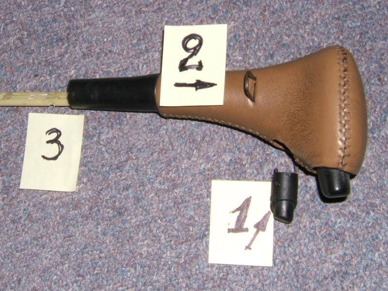

ok so i got a couple of shifter handles and im trying to swap one into my 94. both of the ones i got when i pulled them the plastic piece that the o.d wire hooks to came out i thought nothing of it. i pulled the one in my car off and it stayed in with the od wire hanging out with a connecter on it. how do i remove the plastice and wire to put it in the replacement?

!!! CAUTIOUSLY !!!
MARK VIII 93-96 install Shift Knob
For the Mark VIII 93-96 it's important to change the OD button first because of the way the electrical contacts work:
1. Carefully take out the O/D button.
2. Take out the shift knob fastening;
3. Carefully remove the shift knob;
To install a new shift knob do these steps in reverse order because of the O/D button contacts! (It is possible to damage contacts of the O/D button!)
