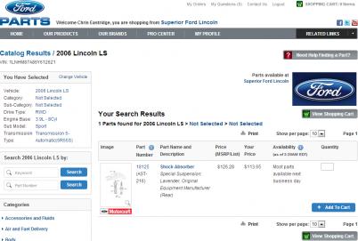

I just ordered 4 sport shocks from fordparts.com, the "special" kind lol. A dealer in Texas took the order but called me shortly thereafter. The man stated he could fulfill the two fronts but the backs were no longer in production and couldn't find them anywhere.

I talked to gentlemen from the dealer in Texas who fulfilled my fordparts.com order about the parts and it really is quite retarded how they have these parts set up. Apparently every shock variant has a motorcraft part number EG: AST-216, and a Genuine Ford Parts number EG: 6W4218125B, so two numbers for the same part. Then you factor in the 3 different types of LS suspension "Standard, Special, Euro" and you have 6 part numbers now. To further **** you up, the Genuine Ford Parts numbers recently changed ever so slightly.
I was very lost so say the least but I have it figured out now. I ended up ordering the front sport suspension from Fordparts.com under the Genuine Ford Part number, and the rear spot suspension from Fordpartsgiant.com with the motorcraft number using the link you provided.

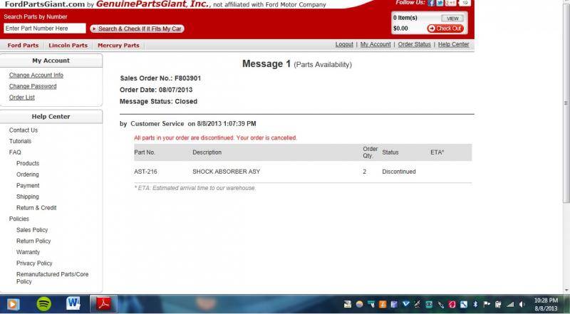

Well, what I assumed has come true. Yeah, places other than fordparts.com are listing the AST-216's rear sport shocks, but that doesn't mean they have them.
Got an email from fordpartsgiant.com where I attempted to order them from the link that jjcool00 provided above.
"All parts in your order are discontinued. Your order is cancelled. "

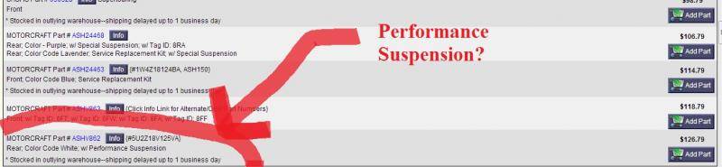

From my understanding "Standard Suspension" is not the sport shocks.
Different shock part numbers for "Special suspension" are available from rockauto if you select different years, any word on if these are compatible?
01 & 06 Sports shocks are different?
I'm looking at a whole set of different numbers here from something Max @dealership quoted.

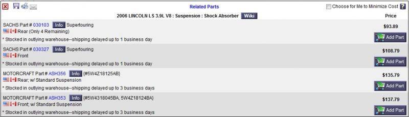

Looking back on rockauto and the Sachs "super touring" product numbers don't change from generation to generation which is interesting because there are still rear euro shocks available for 2002 models. I just don't understand why every place lists shock incompatibility between generations, if some cheapo sachs are the same for both. Anywho, I think I found some actual 06 rear sport shocks from some dealer in Florida, just have to wait on an email. Why is this so damn complicated.

Yeah it is a bitch. Interestingly enough, like LS4me pointed out, the Sachs Super Touring rear shocks product number 030103 stay the same throughout the entire 00-06 model range so it appears that they are all interchangeable. However, I am not going to order some just to figure out I am wrong and have to ship them back. What would really be nice is for someone with a vast knowledge of the LS *cough joegr cough* to come and confirm that the shocks are all interchangeable throughout the years.
