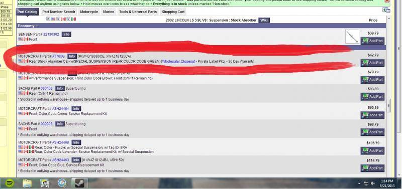

Just an update here. I placed an order through Tasca for those AST-216 because they said they had them. Well a week later they emailed me and said they wouldn't be available to fulfill the order, go figure. So back to rockauto I went. I started searching through both generations to try and find something and look what I found.
I jumped on them, because of that price, it's a risk I am willing to take for those kind of savings. Rockauto return policy is still good for these so I feel confident. It's also worth noting they still have those "Performance Rears" in stock for a 2002. To my understanding, those are the Euros correct?

Hite said he would confirm when he got home from work. I called my local Ford/Lincoln dealer and had them run the AT705G and they said it was a rear. AT705G is the motorcraft number, the long ford part number is XW4Z18125CA. They said the 18125 indicates rear, a 18124 would indicate front.

Rockauto has this AT705G listed as special suspension. My understanding is Standard= standard, Special=sport, Performance=euro
