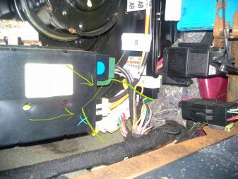

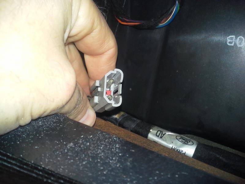

previous owner lived out in the woods and the alarm was going off in the middle of the night (presumably from animals crawling on the car) so they somehow disabled the security system without affecting the drive train, air ride, heat/ac, or lighting.
Any ideas on how they disabled the alarm? All the fuses at the driver's door panel and pwr dist box are present and unbroken
behind the glove box this little 2 pin connector was open, i didn't find a matching, open connector nearby
