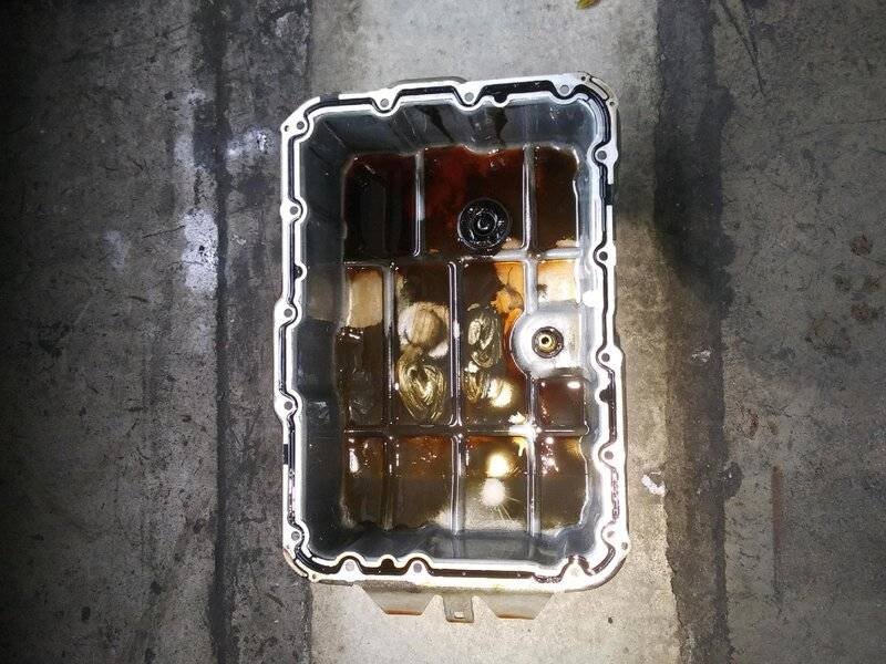

I have a 2003 LS V8 with 46,000 Miles and has major shifting issues that started out of nowhere about a week or so after I purchased the car. So I figured maybe a shift solenoid as I know the history of these cars. So I purchased everything and am having the fluid changed, filter, and the shift solenoid pack changed as I type this message. Once they dropped the pan they sent me picture messages of how bad the fluid and such looked. They said this looked very bad for a car with such low mileage. I asked them should I be worried about needing a rebuild and they said I will be lucky if not needing it in the next 6 months.
They said I should repeat the transmission fluid change in 90 days and change the filter again and that will give me a better idea if I am going to need a rebuild. The question is should I really be worried as they said or should I find a better transmission shop for my next fluid change. Thanks in advance to all!

I just got it back and I am going to have to rebuild it or find a good used one. The Shifting feels much better but I feel the same gears hanging up and even reverse is still rough. Thanks @joegr you were correct as always. But just in case and I dunno if it will help but I am going to try and reset the computer so it will relearn driving conditions again to see if that can make any difference but I suspect it won't but figured it can't hurt to try.

I found another thread on here from 2017... but lost it. A member on here had bought a 2003 from an old couple... and it had about the same milage as yours. He had pulled the pan and took pics of it. It looked as bad as yours.
