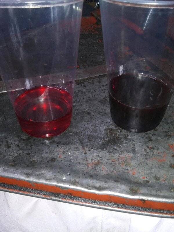

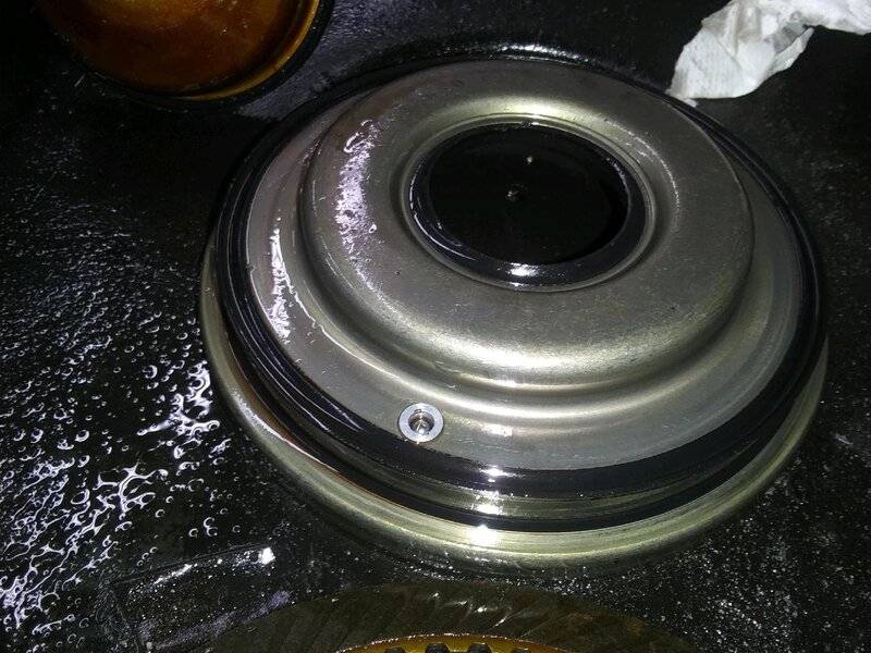

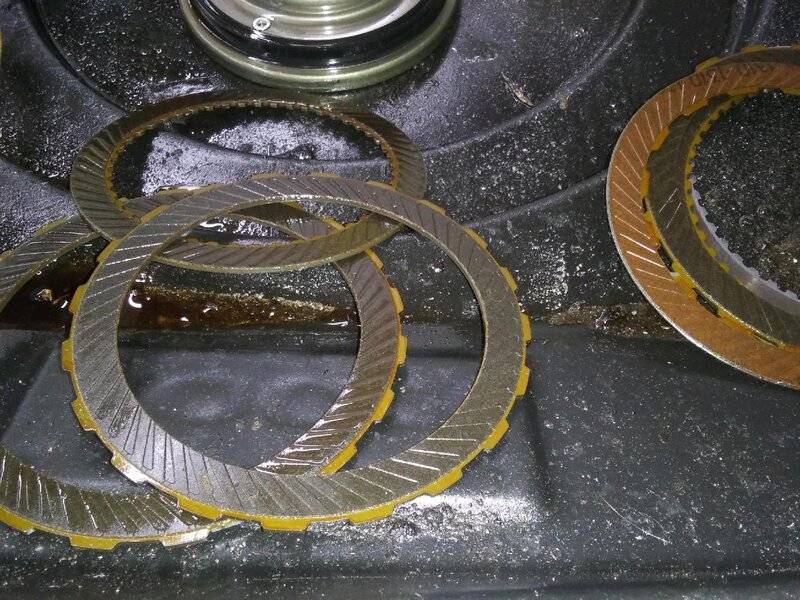

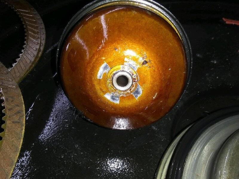

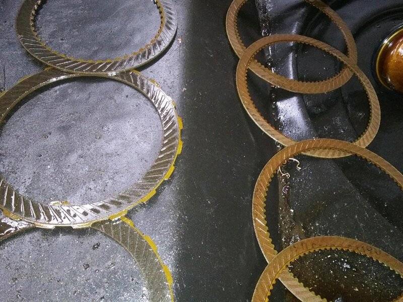

Here is some pics from the transmission tear down that the shop sent me. Also the fluid picture shows new fluid on the left and the old on the right. Also keep in mind I had the fluid changed in the transmission less than a month before this pic was just taken. They also said the servo had started to crack and some rubber seals on the piston are rock hard where they need to be soft.
Thanks for the background info on the transmission teardown. I learned a 20k fluid change interval is good. I would for peace of mind, insulate the complete exhaust system at least to strap clamps if not to the muffler trumpets. Mega work but well worth it. Make sure they ( trans shop ) flush out the transmission cooler between the radiator and condenser to rid the particles and worn oil ( warranty purposes ). Might want to replace the trans cooler hoses though they are 15-17 years old with a vinyl hose protector ( cheap insurance ).
