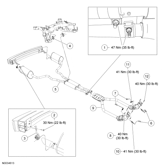

http://deneau.info/ls/
you can clearly see that it is a three dimensional chamber, not a flat stamped piece of metal.
I'm really not sure what else you would call a big chamber with a couple of layers of honeycomb material in it.
You're right, I should have prefaced my post with a 'On my '05... I wonder why they used several different exhaust setups, Cali maybe?
Awesome, thanks! So it would seem that the "redesign" for 2006 included a third cat in that location, which backs what BlackLS06 has experienced.
Neither of my '06s has that piece. Their systems are exactly like the one on the '00.
except for mine is a early 03, which is first of the 2nd gens, its fricken weird because it doesn't seem to matter when its made. the only thing i can think of is that it has to be region related, but ive seen both versions more than once here (i guess it is possible for them to travel all over, just wish somebody really knew the answer)
even weirder, i would think if anything, the peoples replublic's cars would be the ones to have the third cat.

Just to add to the confusion...
My 04 has the "three cat setup" and the hood label says it is California LEV certified for 04.
My 06 does not have the third cat, and the hood label says it is California ULEV certified for 06.
ULEV = Ultra Low Emissions Vehicle
