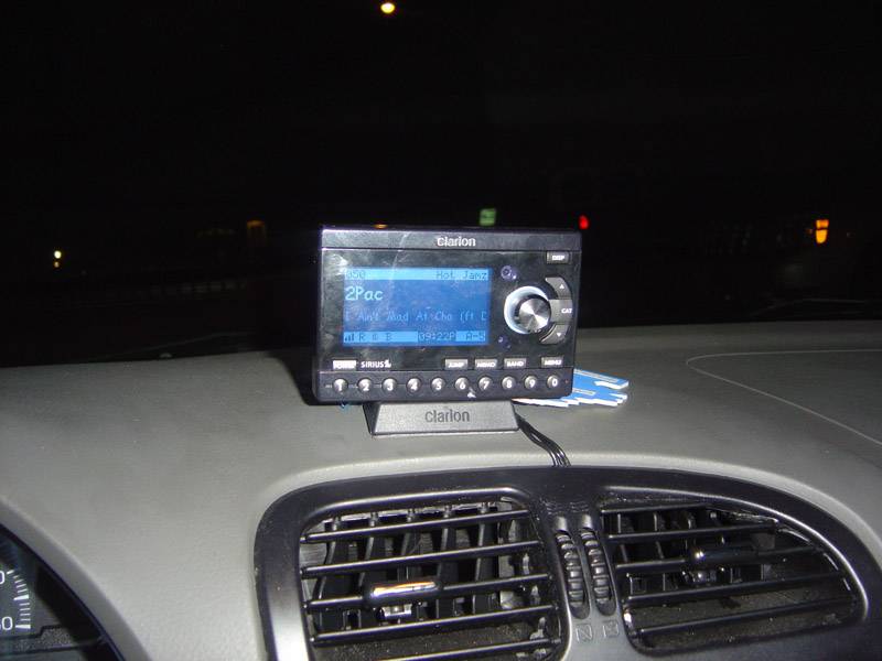

Hey I have one also what i did was get some double sided take and stick it right above my ac vents and ran the wires out from the back of vents and boom done as far an wiring it up under dash easy you have choice cut the cig light adpt off *no good for me* or buy a two way adtp from walmart or anywhere and cut it and wire that to power source and plug cig light into it * not sure if you understand what i mean * or you can splice into the wires and wire them up * used connectors that pintched on and no cutting or anything I can pull everything out and never tell it was installed! I will take some pics tonight of everything im talking about. dont have camera and about to go to school

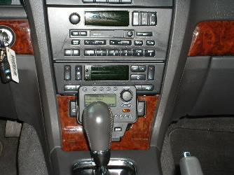

Mine is HARDLY a professional installation. However, it might be some food for thought. I removed to ashtray assembly, door and wud trim. I then fitted a plastic mounting plate that I fashioned out of the top of a cat litter container. I mounted the reciever to to it, screwed the plate into lighter assembly mounting holes and snapped the wud trim back into place. It's very sturdy. As for wiring, I came off a fuse in the passenger kick panel with one of those fuses that turns one into two. The other end is a "Y" adaptor that gives you two lighter ports. I plugged the reciever into one and let the other stick out between the center console and the dash near the floor. It's easy enough to plug your phone into,yet barely visible. All the wires are either behind the dash or running inside the console, well under the passenger seat, under the door molding and into the trunk. My antenna is mounted just behind the brake light on the rear deck. The hotwire is on an "always on" fuse, but the receiver has an auto-off function, so I don't sweat it.

NICE do you ever hit it with the hand tho? I was thinkin about doing to there also put i dont want to knock it off or my luck crack the screen on day putting in into park (dont ask I m not Puching it into gears just bad luck

There's about a half inch between the receiver and shift knob, when in park. I made a slight adjustment in how I hold the knob. It's not a big deal for me and some receivers may afford more clearance there.

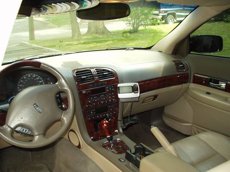

A company called Pro-Fit makes a "Vehicle Specific Mount" (VSM) that installs perfectly in the LS and pretty much any sort of satellite radio or MP3 player can be mounted to it.
that where is had mine Im going to snap a picture of mine right now BRB.

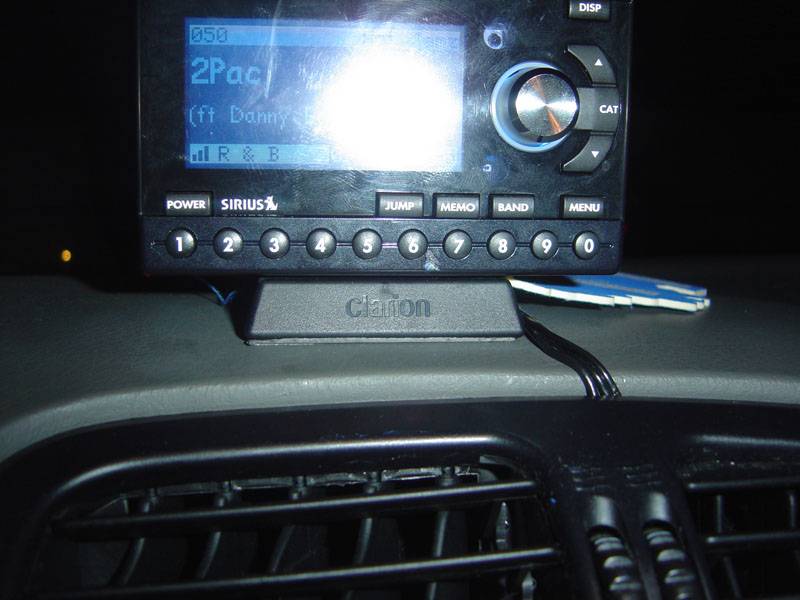

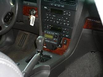

OK so here are my pics Dont know why all my stuff looks dirty! I just cleaned it and there are not finger print when you just look at it (SCARY just saw white noise so maybe this camera is looking at something else)
the last pic is the old setup
