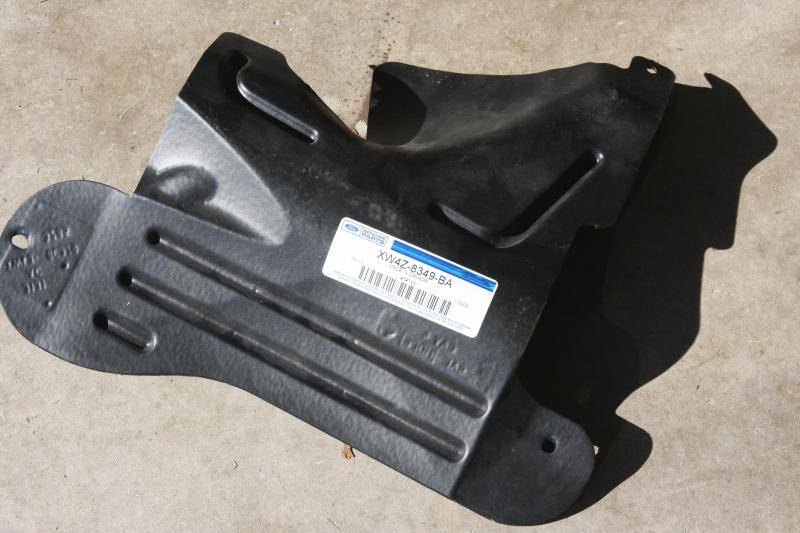

I was lucky enough to get one of these shields from a local dealership that was clearing out their stock (2 years ago). Got this for $8. This is the driver side shield you may be looking for.
He may well need that one too, but the alternator is on the passenger side...
