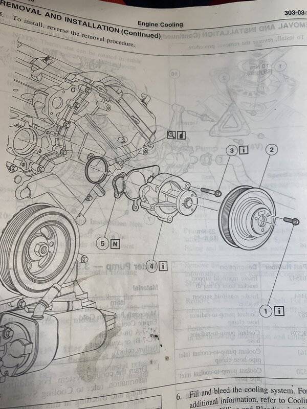

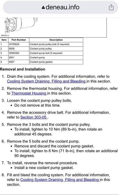

One other thing I discovered while replacing the water pump was that the screws mounting it to the block were not tight at all. The hack that installed it (your truly), has a tremendous fear of stripping bolts and bolt holes. They are intended to be pretty tight at 8Nm and then another 90 degrees. That could have also played a role in my “slight leak.”
Finally, in my 2004 service manual, there is an O-ring that was installed between the water pump and the block that isn’t in the 2006 online manual. I suppose Ford determined that the O-ring wasn’t necessary.
I don't recall that. IIRC... all the bolts are to be tightened to 89 inch pounds. (0.113 Newton meters).
I don't know what to say. I've put 3 water pumps on my V8 and just torqued to 89 inch pounds with no leaks... unless those procedures are for the metal Jag pump. (shrug)
