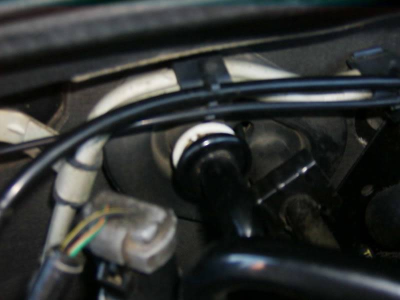

While out driving today I noticed a small amount of smoke coming out of the dash vents the temp guage was normal I pulled over and looked under the hood and there was no obvious smoke coming from the motor but I did notice this
I tried to push it in but it would not move could this be where the smoke is getting in? how do I get the plastic washer flush with the fire wall? love taps with a hammer?

You got it. Your heater core is leaking my man. I wouldn't drive it too much longer, otherwise you will have a pond of coolant on your passenger floor. Time to replace, or bypass.
that plastic washer is from original assembly at the factory. its not meant to seal anything onc ethe car is built.
First, your looking at the AC lines. And as said, thats from factory and they are at almost every connection, including fuel lines.
The large black seal around those may never sit perfect.
And as said, if you getting smoke and steam out the vents and such, your heater core is about to go boom!
