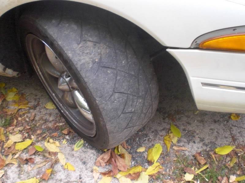

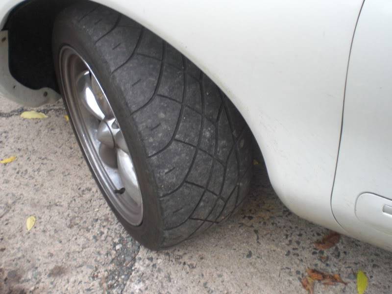

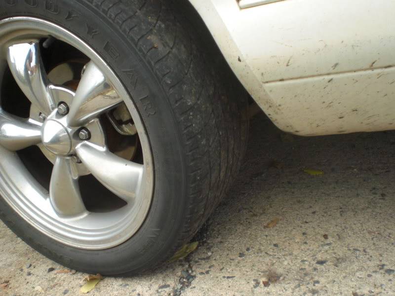

I'm thinkin it's time for some general maintenance
I'm thinkin it's time for some general maintenance![]()
holy flapkacks,i have a little rattle starting in my high mileage front, but nothing like that,whats it do when you drive it?
I think you need to state with cleaning those wheels. lol.
What kind of wheels are those?
Was it the front passengers tire? Could explain some of your problems no?
My 96 did that until last weekend. I wient to Murray's Auto and bought 2 new upper control arms, both lower ball joints, Ball joint to strut arm bushings and lower control arm bushins. Had it aligned and guess what, problem went away. There was so much slop in the upper arms viagra couldn't keep them up.
This post answered my question about the tire wear and noise... When I received the car the old tires were worn more than the rears on the outside. I thought it was just an alignment issue.
Along with stiff steering, noise over cracked roads are an issue.
I was going to have it aligned since my new tires were put on last month. I peeked at the lower bushing and it does seem worn.
Do I have to replace the Lower Control Arms too? WHat symptoms reflect my need for LCA replacement??? <---------------
Do I just replace the LCA Bushing or go for the whole Control arm since it comes with Bushing and Ball Joint for each side???????????????
The issue here is money, and as stated.. you're going to take the arm off anyway might as well right?
or do I just replace the bushings to rid of noise, pull, and drastic tire wear?
