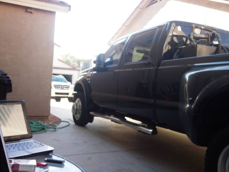

Just for you, Fastmark. :p

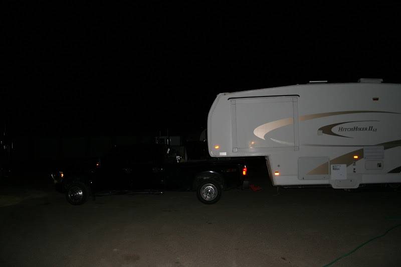

This is what a truck that works to earn it's keep looks like when it's pulling twice it's weight around.
And this is what it looks like when it's in "vacation" mode.
That's one hell of a truck. That front setup is mean as hell haha, loving the Christmas scheme. Any flexibility to that rope at all?
Meh, when I need to tow heavy things I just use my Mark. :D
frog i see what got you hung up was the drop on the hitch actting like a tailhook on an f-4. just an old mans wize a-- comment. take care just made a run from mikes 892mile 12.5 hours.
