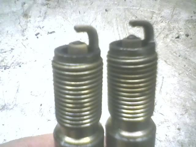

I don't have a lot of experience with those Iridium, but I can tell you that the 100K claims on the Platinums are total BS in my experience. Here is a pic of what the Platinums usually look like when I change them at the shop in customer's cars.
These particular plugs had about 80K on them:

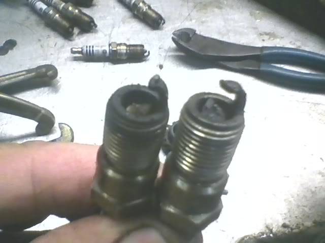

Oh, here is another nice set of Platinum plugs I changed on another car:
Wow. Mines looked new. In fact, I only knew they were original because of the paint on them which I had to ask about.
The first set look bad but the second set looks like the engine was ran often but rarely up to operating temp. Something else besides normal or acceptable wear. Ouch!
