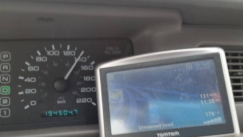

I see here that the 98 M8 is not supposed to be affected by tire size, but I am getting a different reading with the smaller diameter tire, anyone know why?
140KM = 87MPH
131KM = 81MPH

Thanks Chris! It is what I originally thought as every car I've seen the tire size would affect the speedo. However, I know you guys know these M8's very well!
