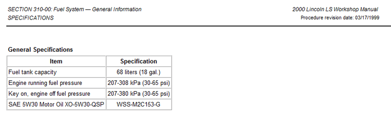

Amazing - as my wife cranked and engine started the pressure got barely to 10 psi. Then quickly went back to zero as engine stalled. I know both of those results are bad. Remember I was able to get the car started and stay started by jumping across the fuel pump terminals.

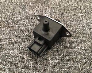

The fuel rail pressure sensor, shown below, tells the computer what the fuel pressure is so the computer can cycelt the fuel pump on more or less to gain or decrease pressure.
Tried to get a V6 pic but wasn't able to copy and paste but they're all over the web...you should be getting at least 32-65 psi when engine is running
At 32PSI your still within specs on the fuel. If you want to try and bring the pressure up more then change the fuel pressure sensor and filter.

Could be a bad pressure sensor ...It will have a circular metal shield around it ...sometimes this is called a fuel pressure regulator
No, it's not at all like that. The LS is a returnless fuel system. There is no regulator! Say it with me. There is no fuel pressure regulator and there is no air temperature blend door.
On the V8, the pressure sensor is at the front of the passenger side rail. I not sure about the exact location on the V6. It's not round, it's rectangular.

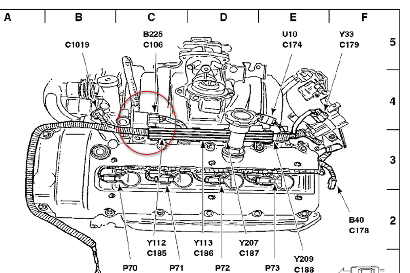

I know right where it is on the V6. At the very back of the fuel rail, surrounded by a metal shield just as Dutch said. I got the shield off yesterday and will attempt to get the sensor off today. It is very difficult to get to, which raises the odds of it being the problem. I hope it is.
Thanks as always for the assistance.
Are you sure? There is a fuel temperature sensor at the very back of the rail.
Edit: Looked it up. Yes it's at the back on the V6 and it has a cylindrical cover of some sort around it. The fuel temperature sensor on the V6 is on the rail at the fuel pressure test port.
See edit above. You are correct.

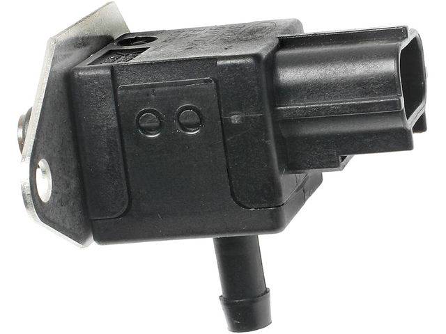

I see that there is a sensor PA CARGO brand for V6 LS
Yeah check the pic for that. Not going to fit. Has two locating tabs that are noot present on mine which I got off. The PN printed on it is
XW4F 9F972 AD. ebay equated it to FPS7 but I'm not biting yet.

Yeah check the pic for that. Not going to fit. Has two locating tabs that are noot present on mine which I got off. ...

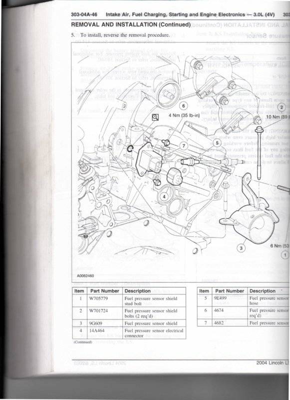

The service manual shows the V6 one as having the same tabs as the V8 one. How is yours held to the fuel rail without them?
It and the Ford parts site shows the same part for the V6 as the v8.

Yeah definitely. What u pointed to above was the exact part number. But it was sold.
